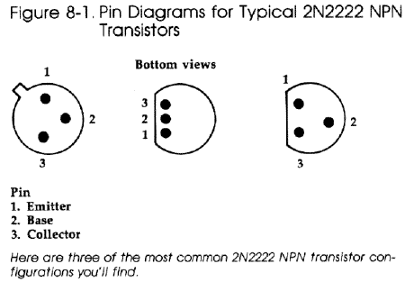

Hello, I could use some help trouble shooting a Steiner VCF.
There's no output.
Power is reaching the board.
The wiring is correct.
Polarity of capacitors and diodes are correct.
Diodes test ok.
TL071 switched out, no change.
After a bit of testing I realized the 2N2222's I had were in backwards.
I have the middle ones in the attached chart. For some reason the emitter is on the other side for this type.
After switching them around they test ok,. still no output.
At this point I'm not sure what I have left to test.
Any ideas/help/direction would be appreciated.

ok,. I found that bypassing that last resistor makes it a lot louder, about signal level.
Now it seems to be working ok except for the resonance pot.
When I turn it down, it attenuates the signal as well.
Also, it doesn't approach self-oscillation when turned up.
Is that how it's supposed to work?

assuming you have PN2907 for the PNP transistor, it looks like it may be in backwards.
PN2907 datasheet
hope it is as simple as that. this filter is the best!

Thanks guys.
I tried switching the 2n2907 around and that made it sound really crazy so I changed it back. Weird.
But it's working great now,. the 2k2 resistor in the resonance section just needed some adjusting. I ended up putting a 1k pot with a 1k resistor in it's place so now I can get really wild overdriven resonance if I want.
And with all that resonance there's a lot more signal so I put the output connection back to normal.
