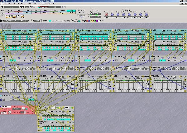

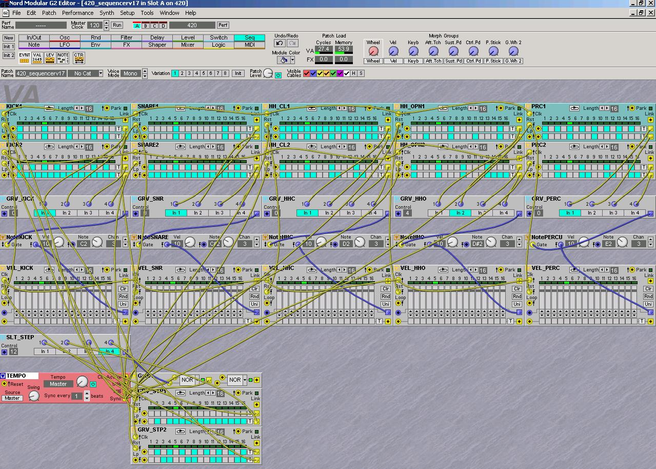

Hi, This is my second patch with my G2X. I made this patch to control my drums in a external sampler. I tried to recreate some interesting features from a RS7000 (Yamaha)
Features :
-enable/disable all steps manualy for each part
-Change the groove for each part separately (kick, share, etc...)
-Choose only the step you want to play in the loop
-Edit velocity for each step for each part
But I have a problem. If I select just 12 steps to play in the loop...every x beats the loop restart brutally to the 1st step. I supose that I have to use another number from "1,2,4,8,16,32" to sync all my sequencer in my patch. I think it's possible to do this. Do you know how to do ?
you can see my problem in the patch attached to this thread.

I am guessing what you need is a different reset signal for the sequencers so that they don't reset trigger every so many beats, could you not just use the Clk Active as master reset for all the sequencers and then let them free run from there on in?
Sorry if I have misunderstood your problem, I am at work at moment, so can't play with your patch./ Smile

Thank iPassenger, it's exactly this. It's work fine now.
I don't know as well as you my G2 at the moment but I love this beast ! And now I have to say bye to a part of my social life :p
