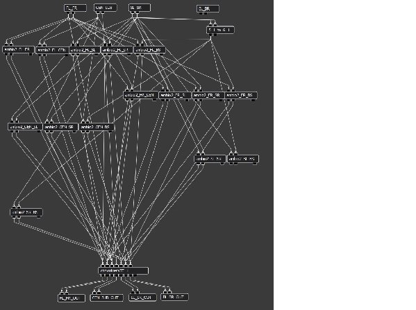

Thanks again rmiller for your answers. A fully multichannel ambiophonic plugin would be awesome! From what I've tested in the past (both hardware and software), only multichannel DRC arrives at the same level of dramatic sound improvement.
Previously, in my 6.1 setup, I used audiomulch and several ambioVST instances for EACH pair of speakers, all with all (i.e. FL & CEN, FL & FR, FL & SL, FL & SR, FL & BS; CEN & FR, CEN & SL and so on) (see the attachement "full 6.1. ambiophonics"). My idea was to use all the speakers at the same time but cancelling the crosstalk between ALL of them.
If I understood correctly, in order to implement ambiophonics over a 5.1/6.1/7.1 input, the center channel should be mixed in both front left and right channels (with half the volume on each one, I suppose) and the center speaker is no more needed. The same goes for the Back surround channel (I removed it since is was matrixed from surrounds). Is this true even in a non-ideal 16 angle separation setup (i.e. 30-40 degrees)? I'm a little reluctant to remove the relatively expensive center speaker...
I attach a capture of the current audiomulch setup for this configuration ("4.1 ambio"): FL and FR channels go to the input of an ambioVST instance, each one mixed with an attenuated copy (-3 db) of the center channel. SL and SR channels go to another ambioVST instance. Each output (in conjunction with the original LFE signal) goes to the corresponding input of a multichannel convolver for DRC correction.
You can see that I modified the delay and Zentrum parameters for both instances from the default values in the "Pop" present. However, the problem is that when I save the layout and re-open audiomulch, the Zentrum value (3) is properly loaded, but the delay value is resetted to the original value (71 us). The same problem appears for "global" parameters such as balance but not for "local" ones such as recursion or space. Is anybody experiencing this problem?
Regards

Dear janderclander14 and others interested in Ambiophonic DSP for 5.1...
I believe that janderclander14's 5.1/6.1 "multi-pairwise approach," showing 15 instances of DSP, goes beyond what is necessary, and may have unintended consequences, generating audible artifacts.
Regarding the need: In normal hearing (live or reproduced) we use small, unconscious head movements to confirm localization, usually horizontally on the order of a few degrees, but up to about 45deg max if a bus is about to hit you from behind. Headphone listening thwarts this, but Ambiophonics allows it to occur naturally. (Ambio could be called "virtual headphone," without the discomfort or in-head sounds, or "speaker binaural.") Since our ears are on the sides of our head, we'd need to be turned uncomfortably beyond 45deg up to fully 90deg on either side to hear binaural between side pairs (in 5.1 terms, between L and SL or between R and SR). In any case, most commercial 5.1 recordings have irrelevant HRTF-binaural information between side pairs, as surround mics are typically many meters from front mics, or surround signals are generated artificially.
Furthermore, Ambio DSP between Center and SL or SR has little meaning. Note that most commercial 5.1 music recordings and movies only pan spot mic signals to C, and so contain no binaural information, and therefore C is not paired spatially with any other channel. (Distances are too great for HRTF-binaural in the case of movie music typically using Decca Tree L-C-R mics; OCT 5.1 micing works, but hasn't gained the traction it deserves.)
Add the unintended consequences: In the multi-pairwise approach there is the artifact of crosstalk-cancellation (XTC) signals introduced, say for the FL-SL pair, into the FL speaker that are not canceled in FR, and similarly for any other partner of a pair either in front or in back, where within normal head-turning range, binaural perception IS at work.
My advice for using Ambiophonic DSP for 5.1 surround as I do is to keep it simple and only use two instances of Ambiophonic DSP, similar to your simpler diagram above (except you need only one control and therefore one instance of MGain for Center signals as the output can be wired to both channel inputs of the following ambio2_FL_FR_CEN contraption). The result is artifact-free 5.1 reproduction within a reasonable range of head-turning.

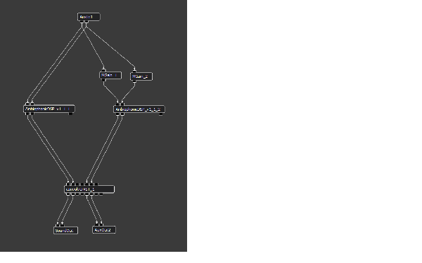

So far I've been enjoying AmbioDSP for both stereo music (using a vst bridge for foobar) and 5.1 movie soundtracks via the audiomulch setup posted above (two pairs of ambio front-back).
A part from the little anoyance to re-set the configuration delay (as stated above) which I suppose it can be easily fixed in a new revision of the plugin, I can confirm that the listening experience is highly improved. For movies I found that, even using dipolar speakers, the fact that they have been DRC corrected supposes a quite satisfying integration with the expanded front stage, but providing a wide and diffuse soundfield which actually came from the room, not confined to the speakers. The only consequence is that surround sounds are harder to localize that front ones, but I found this quite desirable. The result is an amazing almost 360º sound envelop.
Now I am interested on trying the bi-ambio setup stated previously for stereo music (i.e. using also the back speaker pair). If I understood correctely, I have to replicate the stereo front signal, attenuatte it (6 db) and feed it to back speakers (FL-> SL; FR->SR?) through a new ambio dsp instantance. I'm attaching the audiomulch audio layout fo this setup. Could you please confirm if it is correct?
Another question: in order to apply a multichannel ambio currently I use a VST host and a virtual audio cable application which, in conjunction with ASIO drivers, redirect the sound from the player's output to the host (to apply DSPs) and from that, to the soundcard's outputs (my soundcard does not support rewire or native re-routing). Even though this procedure works, I experience some sound drop-outs (no matter which asio buffer I use or how much I increase the latency and process priority) and I have to manually set the vst host every time.
In this sense, a directshow sound filter which could be loaded directly on the player (like ffdshow audio filter) will provide a much better integration with the application and a greater reliability. Do you think it could be possible to offer a directshow version of the dsp for multichannel audio (similarly to the multichannel convolver I'm using which offers VST and directshow versions in the same package http://convolver.sourceforge.net/)?
Regards,
