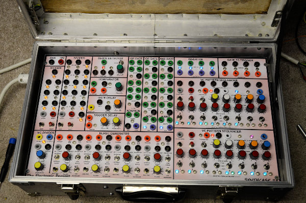

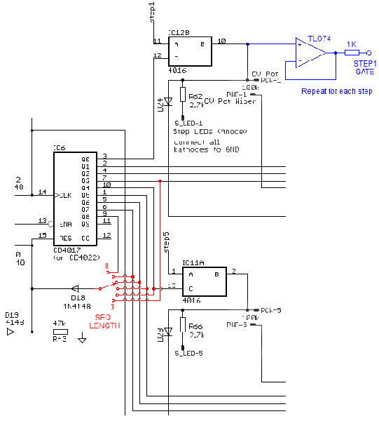

I have successfully completed two VCPS modules as part of my SynthCase 3 project. Details can be found here:
http://www.electronicpeasant.com/projects/syncase3/syncase3.html
I have made two circuit modifications to the sequencer. First, a selector switch was added to allow adjustment of the sequence length from eight down to seven, six, five, four, or three steps. Second, a gate output signal was added for each step, using a simple op amp buffer circuit. The changes to the circuit are shown below, with the buffers marked in blue and the sequence length switch in red.
These are excellent little sequencers, thanks for another great project Fonik!

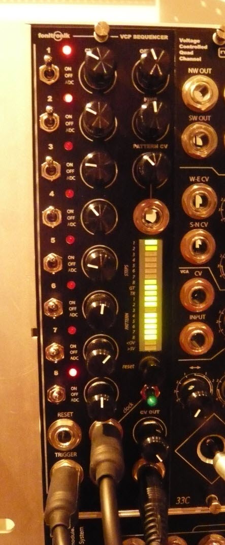

i built my VCP,i have a few questions.
For what serves the processed output?
and how can i raise up the level oft the trigger and gate outputs as now it does not trigger my adsr's ?
PostPosted: Sun Apr 03, 2011 11:49 pm    Post subject: Reply with quote  Mark this post and the followings unread
the processed CV out is just a goodie. i even did not bring it out to the front panel on both my units. however, it enables you to use the voltage processor as a module on it's own, when you don't need it for the sequencer.
actually it should not be necessary to amplify them. what voltage do you measure for the gates? would the clock you use fire the ADSR's?
the voltage of the gates depends on the voltage you set for the steps (see buffer opamps for the steps), and for the trigger voltage the original clock voltage is important too (i believe the clock you use would fire the ADSR's?).

Matt, seems trig and gate is fine no and it fires the adsr,i realy don't know what was wrong last weekend
i measured at the trigger i have 8,9V and the gate stays on 9V no mater what the pot settings are.
but trigger now fires adsr so thats ok.
I built the mine with the LM324
i have just 2 other problems now
first one:
between each step when it shifts from step to step the pitch (voltage) jumps a bit higher until the next step playing.this gives some enoying tremollo fx
any idea whats the problem doing this?
