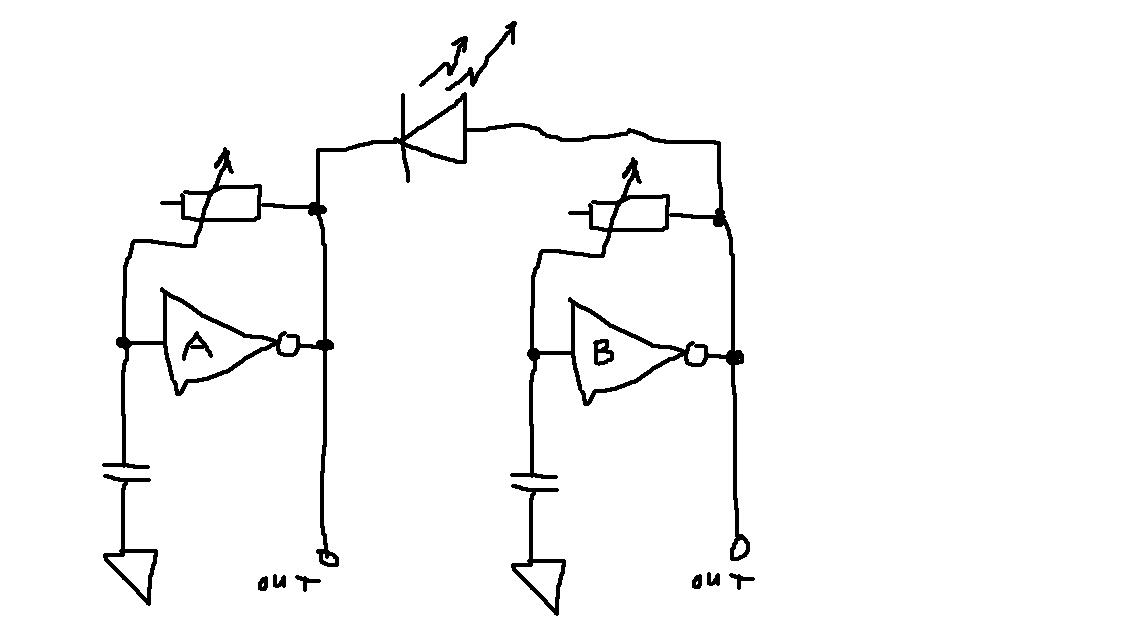

And again on my current obsession Wink :
I thougt I was gating with the LED's, put on my "I want to know" hat, and was trying to figure out some truth tables.
These conditions without a LED:
A B
0 0
0 1 *
1 0
1 1
Expected Gate effect with LED
A B
0 0
0 0 *
1 0
1 1
* change
But then, it doesn't sound the way I expected from my theory. Several actions are happening at one.
Pulse Width.
Charge and discharge of the timing capacitor determin wether you get a Hi or a Low. In 40106 PWM schematics diodes are used to influence Pulse With. Suppose
oscillator A is Lo, oscillator B is Hi , current can flow through the LED or diode, so now oscillator B has to charge capacitor A as well.
Imagine more LED's for example from A to other outputs, some reversed polarity, things are getting complicated.
Next, more complicated still: Bleed through
The output B is connected to output A but with reduced voltage, depending on the LED's "diode drop" voltage.
quote:
" It is safe enough to assume 1.7 volts of voltage drop for non-high-brightness red, 1.9 volts for high-brightness, high-efficiency and low-current red, and 2 volts for
orange and yellow, and 2.1 volts for green. Assume 3.4 volts for bright white, bright non-yellowish green, and most blue types. Assume 4.6 volts for 430 nM bright
blue types such as Everbright and Radio Shack."
source: http://www.theledlight.com/LED101.html
LED as light sensor
http://en.wikipedia.org/wiki/LED_circuit
My LED's are in a row, so adjacent LED's might pick up each other. I still have to check that. If this prooves relevant, putting the LED's in a cluster makes optimum
use of the feature. Or putting a shrink tube or something on them reduces it?
Ok, last for now: Slew Rate http://en.wikipedia.org/wiki/Slew_rate
The slew rate represents the maximum rate of change of a signal at any point in a circuit. Diodes reduce Slew Rate.
I can affirm this is happening indeed, as I recognise the LED sound. Cheap old fashioned Red LED's sound best. Green and Yellow are ok. High-brightness LED's
have less of that fat warm growl.
Some future edits expected

PostPosted: Sun Apr 11, 2010 7:19 pm    Post subject: Reply with quote  Mark this post and the followings unread
Thanks electri-fire and droffset for the LED "gating" idea. It is providing no end to my lunetta entertainment on the breadboard. Nothing so far has burned up while I was putting LEDs between any random CMOS pins. So far.
Now, the big question, which electri-fire was delving into: What exactly are the LEDs doing? I guess they are mixing and gating and shorting? Can an electronics expert offer a more official explanation that might help us take the next step up towards more intentional, more complex use of LEDs?
The sound makes me think that I've tapped into an alien world.
By the way, I am running my 4000-series CMOS chips on a 9V battery but I see 5V recommended in the documentation. Is 5V better?
Thanks also to dgtom for the 4066-switched-capacitor idea which looks like fertile ground for more experimenting, too.
Maybe we can make a synth from just LEDs and capacitors? Plus a 40106 oscillator.
