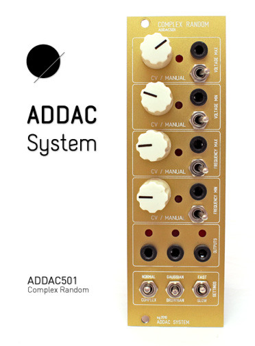

here's a couple new modules in the ADDAC System:
ADDAC501 Complex Random
ADDAC501 Complex Random Expansion
demo videos here:
http://vimeo.com/17391786
http://vimeo.com/17391272
more info very soon*
all the very best
andre

PostPosted: Wed Dec 08, 2010 3:46 pm    Post subject: Reply with quote  Mark this post and the followings unread
Very nice looking modules.
What dacs are you using?
Also what voltage ranges are supported?
__ag
Joined: Feb 18, 2010
Posts: 4
Location: Lisbon
PostPosted: Wed Dec 08, 2010 7:02 pm    Post subject: Reply with quote  Mark this post and the followings unread
16bit analogue devices dacs
for now voltage inputs from 0 to +10v, although i'm working on some side modules that will accept from -10v to +10v
best
andre
