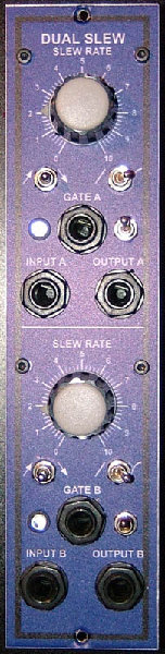

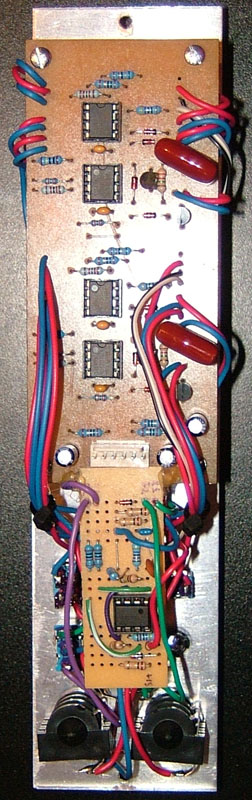

Hi:
I always liked legatto portamento (portamento is on only when you play
legatto), also called auto-glide.
To implement it I need the protamento on all time and turn it off briefly
when a gate-on is received, so when no gate-on is received the portamento
will be on.
To do that I need a negated trigger (an active low trigger). I used the
Ken Stone Gate to trigger as a base of the MOD. As I needed the trigger
inverted, I swapped the +- inputs of the opamp. Also I changed the 10nF
cap to a 100nF because the trigger was too short and didn't turn off the
portamento.
This circuit should be placed before the Gate input of the Yusynth Dual Slew.
Finally I added a switch to the frontpanel to select normal behaviour or
legatto portamento.
To get legatto portamento send the pitch CV to the input of the Slew, the
gate signal (from the MIDI-CV interface or keyboard) to the gate input of
the Slew, and the output of the Slew to the CV input of the VCO. And turn
on the mode switch.
Dual Slew Frontpanel with MOD
 Filesize:  72.29 KB
 Viewed:  398 Time(s)
Duakl Slew Back - Showing the little perfboard with the MOD
 Filesize:  107.68 KB
 Viewed:  422 Time(s)
