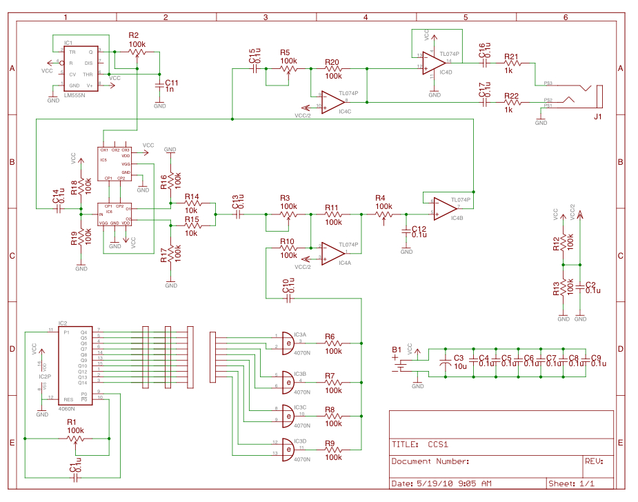

OK let's talk about the CCS schematic as shown below in graphical form. It has a CD4060 counter because that one of the CD4020/CD4040/CD4060 series has an on-board oscillator. I don't have any of those in stock. I just have CD4020 and CD4040, and I'm tight on cash as always so I must make my parts order from one place only for this project. That place will probably be smallbear electronics because they have the boxes and box accessories that I need. Long story short, I'll need an external oscillator.
The schematic has one major error: the CV input of the 555 oscillator in the upper left corner should be connected to the CV output where the aggregation resistors tie together (after the logic gates). That will enable the sound of the KS loop to change in response to the BS output.
I am tempted to use linear CMOS because it would eliminate the artificial ground while providing six amplifiers instead of four. However, there should only be a need for four amplifiers so I think I will stick with the TL074 opamp.
Also the volume and output driver section is a bit of a mess and needs tidying up. I will think of something cleaner to use there. Possibly an emitter follower to act as a headphone amplifier.
Instead of a patch panel, there will be some switches for changing up the music. Also I may use some pots in the aggregator section. The only problem is that brings me up to six pots and about four switches, which will not fit with an internal battery in a BB size box. So I may go up one size on the box, we'll see.
Well, those are my thoughts for now. I'll keep you posted on progress as it occurs.

jpg version of the original Credit Card Synth Schematic
 Filesize:  370.24 KB
 Viewed:  862 Time(s)
