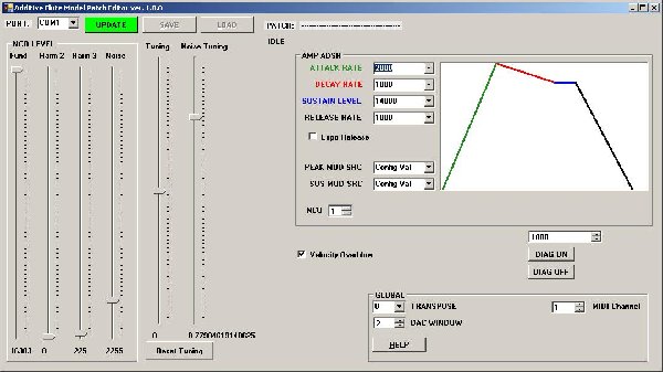

Ah, well, things didn't work out as planned. I totally forgot that I need to create a patch editor to test this. The good part is that if this thing works well enough, I will be able to use the same patch editor on the dsPIC version as I do on the FPGA version. So that will be today's task, write a patch editor (this will be in VB.NET Express Edition, the free one).
FPGA Synth Stuff
FatMan Mods
dsPIC Synth Stuff
I am formerly known as ScottG here
Time flies like a banana.
If butts had nipples, why have tits?
JovianPyx
Joined: Nov 20, 2007
Posts: 1092
Audio files: 138
PostPosted: Mon Mar 07, 2011 8:02 am    Post subject: Reply with quote  Mark this post and the followings unread
The patch editor is written and I've made the first test of the design. It doesn't work correctly, but it is making sound. This is pretty normal for new designs, I'm actually lucky it makes any sound at all on the first test. Some keys work, others don't and the ones that work aren't the correct pitches...
Back at it...
03-07-2011, I have sound with all four oscillators, the chromatic scale is now in tune - but - the output is not a sine wave. So I have NCOs working at the phase accumulator level, but conversion from sawtooth phase accumulator output to sinewave isn't working yet. The ADSRs are not working either. They act like a switch, not like an EG. ADSRs are a scaled down version of another ADSR module I wrote and apparently don't work at the new scale. ... output looked like a fullwave rectified sinewave on the scope... found the problem... It was a doofus thing, I took output from the raw sine table instead of the SinOut output... [sigh] onward.

I put this patch together to test the synth. The noise isn't right... I will see about a bandpass SVF next. Making it track pitch will be fun...
EDIT ADD: I have not yet added any modulation sources. This is just a very basic test, NCOs, ADSRs and NCAs.
EDIT ADD 03-09-2011: The improvements mentioned here are not in the current output sample, a new sample will be created after these are completed.
I am in process adding velocity and mod wheel control over the 2nd harmonic. These are tested and give the impression of overblow. I will also add velocity to modulate the instrument's summed output for more natural amplitude dynamics. Noticing slight clicks in the output during pitch change, possibly curable with a small amount of portamento.
Also still needed is the SVF BP filter for more realistic noise character. Since the Q won't be very high, I believe I can use 16x16 multiplies for the SVF with 32 bit memory cells.
EDIT ADD 03-12-2011: The origin of some of the clicks was from the velocity value changing when either sustain is held down and different keys are pressed or if one note is held and another key is pressed. I've changed both the design code and MIDI controller code to allow velocity to change only on a new note from silence. However, some of the clicks still persist when note pitch changes. In my research of this, I wanted to implement a single pole IIR lowpass filter to perform a portamento function, but I discovered at least one problem with it - my attempt was to use a 16 bit implementation, but this works best when a0 and b1 are both 0.5. As the values move away from this value, simulation shows me that the output is increasingly inaccurate. This gives rise to a sort of quantization that causes some notes to be way out of tune. I believe that a 32 bit implementation will fix this (previous FPGA projects work fine with a 36 bit implementation and 32 isn't that much smaller). There is also a question of whether the filter is properly coded, but I'm currently stymied on that point. All of this must be fixed or the project is useless to me since flutes should not have clicks...
EDIT ADD 03-14-2011: I have located the source of the clicks! And they are now gone. It was due to me allowing velocity and gate to change at times other than the DACena signal. Now these are synchronized with DACena and that cured the clicking. I am going to remove the portamento IIR filter since it's purpose was to eliminate the clicks and I really don't want portamento on this instrument anyway (since real flutes - well, except for slide flutes but they are really just whistles - don't have portamento).
The last thing to implement is a state variable filter capable of moderate Q to "tonalize" the noise voice. This should allow nice airy flutes if I get it right. My brother and both of my sisters play flute. I remember hearing them as a kid playing flute and when they warmed up the instrument, they would often make airy sounds and it was quite easy to discern a pitch. I want to be able to mix some of that, so hopefully I can apply what I learned with my Tonal Noise Synth to this instrument.
