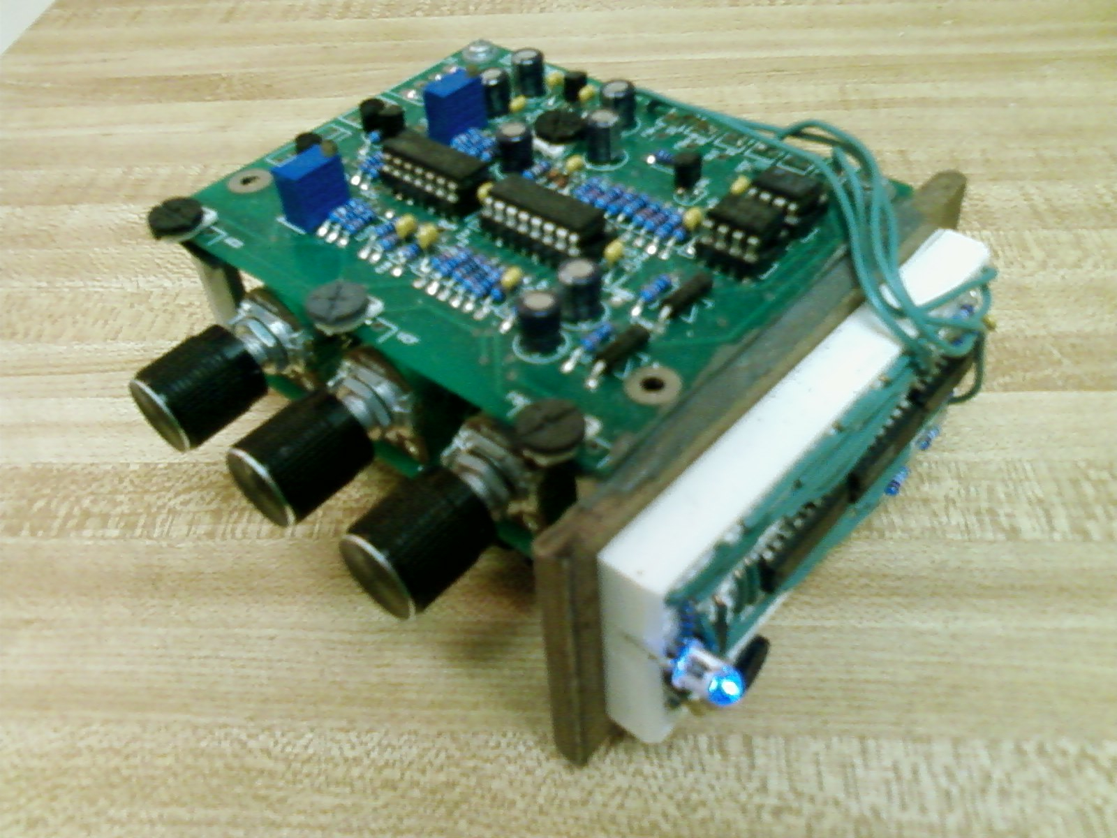

Some folks have expressed interest in owning a "Brick" music synthesizer just like the one I have. One person even said he's going to build a Brick for himself and inquired about buying some KS boards for it. So I figured it would be a good idea to start a thread on the topic and see if it draws involvement.
The Brick is a good little music synthesizer project because it runs on batteries and makes good quality interesting sound with only two circuit boards and a breadboard. I'm selling my Brick for $300, but you can build yours for $150 or lower by following and participating in this thread.
Another thing you can do with The Brick is customize it to meet your needs. You can use any number of BS and KS circuits in combination, mix and pan them, or run off of AC power if you like. The Brick is stackable on standoffs so you can expand it according to your needs.
So let's get started with the next post and have some fun making Bricks!

The Brick's architecture is very simple. A pair of 9V batteries supply power through an on/off switch, a Boolean Sequencer generates the sequence of notes, and two Karplus Strong boards form and resonate the sound.
Now as far as the physical geometry goes, you can do it with just two KS boards but that leads to a wire-filled tangle that can be as neat as possible and still be undesirable, so your best alternative is to use three KS boards. The third one stacks under the other two via standoffs and holds the battery, switch, optional power supply, and Boolean Sequencer breadboard.
Also you may want to think ahead and do an enclosure to protect the electronics. As a circuit designer who is mechanically declined, i just build stuff bare without enclosures though. I've given some thought of coating the boards with tool handle goop to protect them, but have never done so.
I'll post more design details later.
