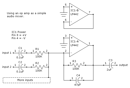

I've done lots of googling and reading about op-amps and mixers.
Seems most mixers use dual voltage, +/-12-15v.
Trying to design one that uses single voltage.
Not sure if I got the virtual ground part correct.
Any insight would be appreciated.
This is what I have so far.

Thanks..
So that will run on a single voltage?
Noticed it's called "virtual earth active mixer", if I read google correctly
A virtual ground is basically a voltage divider on the input,(+) to
cut the voltage in half.
Is that case here?

PostPosted: Fri Oct 15, 2010 5:17 am    Post subject: Reply with quote  Mark this post and the followings unread
Yep, it'll work on single supply. I've used it when I ran my lunetta on a 9 volt battery for a while and it's still loud and proud running on my new regulated 5 volt wallwart.
No bipolar stuff going on here. I have to be more awake to remember the concept of virtual earth though Laughing ! Scroll down to the active mixer section here; it explains it better than I can:
http://sound.westhost.com/articles/audio-mixing.htm
I think it's a very decent active mixer and pretty simple to build.

I am using this design from Ray Wilson's site...
I have 2 mixers in my system and this works quite well. Any general op amp will work. I added pots for volume of each input. Log pots are better as well -linear gives less actual 'control' over the difference between loud and soft volumes...
