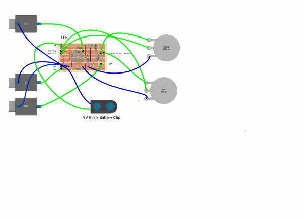

i know this post seems very dead! but i made a stripboard version of the vcf for a microcontroller based application and i want to hear your feedback. Any mistakes?
i am pretty new and not very into electronics. only getting started

i think it would be better to post schematics instead of a layout as most of us (especially myself) are a bit lazy...
schematics are better to look at and see to see if something looks suspect..
first of all i would add in Input resistors for all external Inputs... and then i'm not sure if a 741 will run on 9V... i think it's supposed to be run on a + and - supply... the LM3900 or LM324 can be run on single supplies i know...
but maybe i'm talking nonsense and the 741 will do the job... well as i said i'm not sure... _________________ https://soundcloud.com/bastian-j
thanks for the reply. its the conversion of the picture of breadboard on bottom first page of this thread.
resistor to input. check.
i will check the ic issue. _________________ Sound: https://soundcloud.com/stream Art: http://ketamuworld.blogspot.de/
