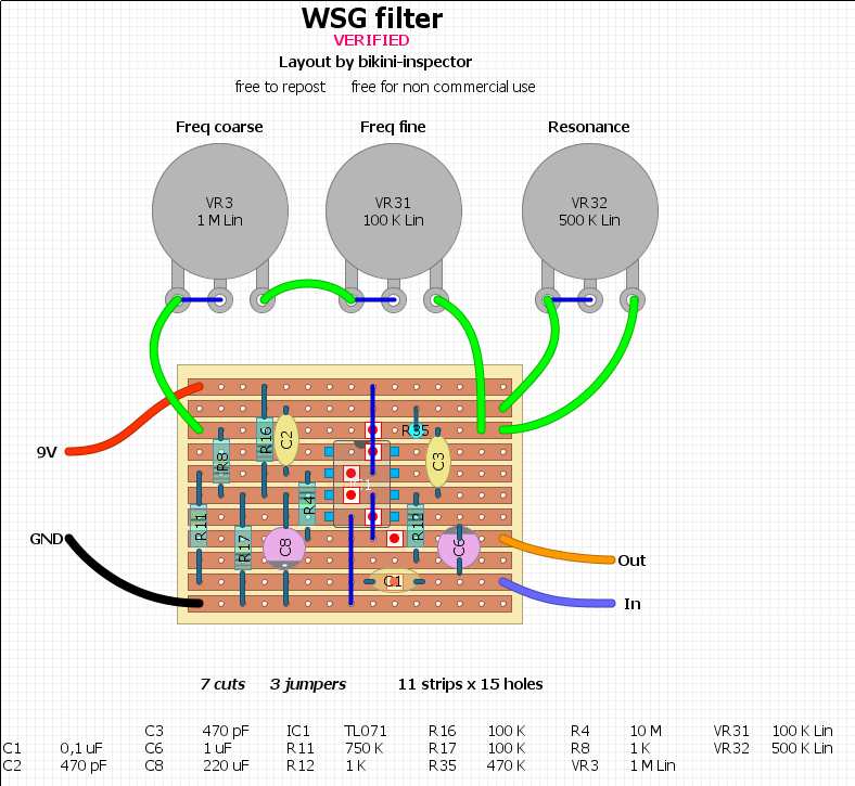

hey folks!
i made a layout for the WSG filter as a standalone unit for use with my apc and the portasound keyboard.
i got it to work on the breadboard with the same components and found it nice enough to build it into a box.
Unfortunately the layout doesn't work, so after staring at it for hours trying to debug this bugger, i have to call out for help. Crying or Very sad
could someone please take the time and look over my layout?
rewards will be eternal gratitude Smile and of course the corrected layout posted for free use by anyone
here's the schem http://www.electro-music.com/forum/phpbb-files/thumbs/t_wsg_filter_schem_2_167.jpg
later, ben
EDIT:
nevermind, i got it working
i forgot C1, not sure what happened there.... Rolling Eyes
also, all the pots are now NOT reversed Cool.
Its possible and nice to have a 1M log pot in reverse for freq, though. In case you'd prefer only one freq knob. More fine-tunable that way...
anyways, have fun!
now verified, pots are viewed from top

Good to hear it's working. The IC is a LM741 though. My WSG filter is still on breadboad. Had a few issues with hum but I seem to have got around it somewhat with additional components... but I can't remember what offhand Embarassed !
I might try this layout of yours and see if I have better luck!

been working on this myself so i thought i'd post my efforts here for others to make use of. still getting my head around diylc so they're a bit messy but you should be able to figure them out.
741 version is built and verified with the addition of led power indicator with current limiting resistor and a 3.5mm mono jack which interrupts the freq pot connection to the board to allow for a light dependant resistor to be connected which are not shown. also, i didn't have a 750k to hand for the input resistor so used 100k (all i had) on board with a 1m pot which lets you tweak response depending on the output level of the circuit driving it and an output level pot.
1458 version is not completely verified as yet but have one side running on breadboard. be sure to check it over before commencing a build referencing the scheme linked to above.
