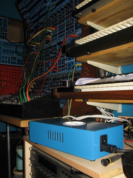

Hello , i've finally finished my diy power supply upgrade for the modular & learned a lot in the process about the balance of regulator supply voltage / current & heat , lots of heat , almost sausage cooking heat . Razz
I decided to try a dual bridge design a friend sketched for me and have my 12V regulators on each of the 6 bus bars / distros which has cured my heat problem i've had for a few months .
I ran a patched up test and left the modular running for 6 hours , mildly warm heat sinks , hurrah! .
Below is a diagram of how my supply is laid out and some pic of the unit, spray painted electric blue to skrog standards , heh Very Happy.
Hope some of the info is useful to owners of rapidly expanding diy synths.

The toroidal transformer isn't really a 15V one, is it? From your numbers it rather looks like a 18V one. The 20V output slightly puzzles me.
Built: MFOS SLMS plus, SL Ultimate & Expander, 10 step seq; PAiA FatMan
Building: Maddox MonoWave; MFOS SLMS MkII; Page TR-9090; TH GM Voice, AY Voice
Backlogging: MFOS 16 step seq; TH SN Voice; Takeda One Board Farm; Okita Vocoder
sompost
Joined: Aug 17, 2010
Posts: 24
Location: Switzerland
PostPosted: Fri Jun 10, 2011 1:02 am    Post subject: Reply with quote  Mark this post and the followings unread
Never mind my comment above. I can see that it's a 15V transformer (but your numbers still puzzle me).
In your design you split the to paths (red-black/orange-yellow) and rectify/smooth them separately. Can you do that? I though that you're supposed to combine them immediately (red-orange) to get a center tap, and then go on from there. Both Thomas Henry and Ken Stone do that in their designs (and they use 18V transformers to get 15V regulated power).
In my calculations I never got more than +/-19V from a 15V transformer, and some commenters doubted that I actually get as much (they suggested accounting for 10% line variation). That would be too close to the required threshold for the 7815. You get +/-20V which looks a lot better.
I believe your measurments. And I am confused.

Hi sompost.
I believe there is no huge difference between having a one rectifier or dual rectifier setup , i just tried this design as it was new to me as i usually have just one rectifier in my other power supply's , i did read somewhere that any AC frequency discrepancies between a two secondary transformer system are settled using two bridges.
The 20V output after the bridges baffles me as well , all my transformers i have bought so far (toroidals) always output a couple of volts more than stated on the side sticker (under load) , and once through a rectifier seem to jump up another couple of volts , perhaps it may be the two sets of 4700uF caps maintaining the peak input cycle , i don't know .
I usually have an indicator led per supply side to act as a minimal load for when there is no modules connected (very rare) and have measured 19.8V , could be the electricity in Scotland Smile Smile Smile Smile

On paper, 20 volts after the rectifiers is about right 15 x 1.414 = 21.21 minus a couple of diode drops for the rectifier gets you about 20 volts.
Looks like in this case the transformer has less load than it's rated for so it's really giving you 17 volts AC to start with.

not sure if i am reading this correct
you are running 6 x 7812/7912 in parallel ? with 10 paralleled outputs off each so 60 x 3 pin outputs in total at -/+12volts should be good for five or six amps total each side roughly heatsink dependent
would like to see a schematic of that section as
normally there are issues with power sharing in such arrangements
and very low ohm resistive paths are required to balance them
but i think you have done something else here perhaps
I am interested as i have to do something soon as I need to make some supplies capable of
+/-15volts at 5 amps or better

Hi diablojoy.
My total load, allowing for 4 more modules, is about 2 Amps per side DC current before the regulators , i chose to make 6 busbars so each set of +/- 12V regs were drawing about 300mA per side which solves my "more heat with less regulators" problem i had before & i can use smaller heat sinks.
Although there are 10 sockets per busbar , i don't use them all, i think about 42 of them.
All the busbars are wired back to the main psu box individually using 16Amp rated water heater electrical cable flex which sorts any volt drop issues Very Happy .
This is not a true Star ground system i have but , each of the busbars 0V comes direct back to the psu caps & 0V tie point as on the drawing at the top of the thread .
