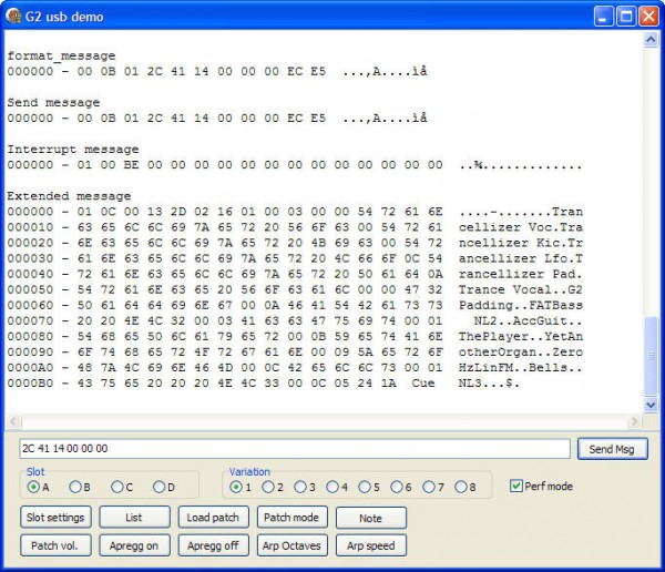

brunov
Joined: Aug 03, 2011
Posts: 169
Location: delft
PostPosted: Tue Oct 18, 2011 10:00 am    Post subject: Reply with quote  Mark this post and the followings unread
Derek,
I use the libusb-win32, that's a generic usb driver that you can put on top of the original clavia driver (filter driver). So you can still use the original clavia software, that's essential i think.
There exists a Java wrapper http://libusbjava.sourceforge.net/wp/
Don't know if you use a windows/linux/max platform? All should be supported according to the info.
I've included a test application that I started with. The units that are important for the connection are the following:
- LibUSB.pas : this is the interface to the libusb-win32 dll
- UnitG2USB.pas
in this there are a couple functions:
Init : to set up the connection to the G2
Done : to close it
bwrite : bulk write data
bread : bulk read data
iread : interrupt read
So basically you send a message with bwrite then you get a message back with interrupt read and when the returning message is bigger than 16 bytes you can read the rest with a bulk read.
I hope this will get you started Smile

Derek Cook
Joined: Dec 30, 2005
Posts: 158
Location: Wales, UK
G2 patch files: 3
PostPosted: Sat Oct 22, 2011 3:46 am    Post subject: Reply with quote  Mark this post and the followings unread
This is just a quick post to let you know that I have downloaded your example, and am working on converting it to Java. I'm not very familiar with Pascal/Delphi, so am on a bit of a learning curve!

Derek Cook
Posts: 158
Location: Wales, UK
G2 patch files: 3
PostPosted: Sun Oct 23, 2011 10:27 am    Post subject: Reply with quote  Mark this post and the followings unread
Well, I can report some success. Smile
I did the initial port, remapping the LibUsb functions to the LibUsbJava wrapper.
The installation of the filter driver went pretty smoothly.
I had a lot of aggravation getting the software to recognise LibUsbJava. Essentially the native DLL needs to be in the C:\Windows directory, which was not obvious.
I then went into debugging mode Wink , focusing on getting the List function working. No GUI at present, everything is being dumped on the command line.
After sorting out basic problems, like the CRC calculation (my errors in the porting Smile ), it all appears to be working pretty well.
So the next step is to try and build the complete test app that Brunov did in Delphi, but in Java, tidy the code up and get it commented and I'll then post the results for others to have a look at.
Regards
