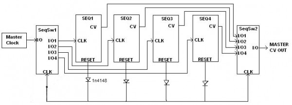

diablojoy
Posts: 730
Location: melbourne australia
PostPosted: Fri Jan 13, 2012 8:18 pm    Post subject: Reply with quote  Mark this post and the followings unread
Emdot i went over that diagram of yours 3 times before i saw the problem with it.
this should work better
only a very small change
edit : just had a thought about it
with this scheme if you wish to send a reset to a particular sequencer to say replay the first three steps through a second time and then go on you cant because the sequential switches will step you away from it
dont know your feelings on losing that but that is something i do use
 Filesize:  52.01 KB
 Viewed:  45 Time(s)
emdot_ambient
Joined: Nov 22, 2009
Posts: 669
Location: Frederick, MD
PostPosted: Fri Jan 13, 2012 9:34 pm    Post subject: Reply with quote  Mark this post and the followings unread
Funny, I was just showing my original to my wife and realized that same error, then I read your correction.
Great minds think alike....eventually!

try this should be all thats needed
use similar for when tying gates together for a main gate out
edit : oh you may need a couple of sections of a cd 40106 to recondition the pulse after the diodes as there will be some effect on the pulse shape
If so try the pdf one
