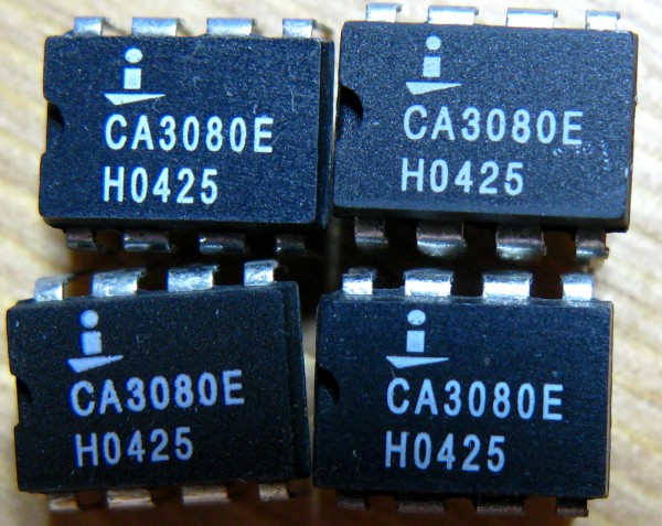

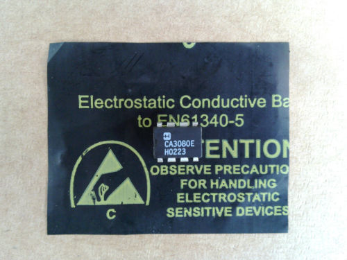

I ordered some CA3080E ICs from ebay in anticipation of a new project.
However, in the photo was a Harris IC, but what arrived wasn't. I don't know how to test these without building the next project, but the PCBs haven't even been manufactured yet.
Below are photos of the IC advertised and the ones that arrived.
the seller "vila_restor" has 100% feedback, but in the comments only people are saying how the delivery times were good, nothing about the actual product functionality.
I know he's a UK seller, but I'm wondering if he bought a stock batch from china and selling them on. These are certainly not the Harris ones advertised.
The current stock is Harris branded.
...unless Harris logo changed to a letter 'i'
Has anyone else had experience with this seller?
Seller's photo of Harris CA3080E

I found a photo of an intersil (which is what the logo appears to be on the chips that arrived). However, it looks quite different...

That's the Intersil logo, which is who owned this design after Harris. I believe there is one more rev (visually) out there as well, but can't remember off the top of my head. That doesn't guarantee that they're good, but this is a proper part/logo. I have both of these types (Intersil/Harris) DIP package versions. There is also a metal can type, but I'm not sure what the markings on those are.
Edit: I see what you mean on the difference between the Intersil logos in those photos. I can take a look at what I have when I get home from work tonight, and tell you what mine look like.

I believe the logo is an "H". Looks exactly like some I have.

I got a few off ebay a few months ago. They were marked Harris and were DOA or fake. But to their credit they sent a new batch of chips with the Intersil marking and they seemed to work great.
I wouldn't be overly concerned about the graphics not looking exactly the same. My guess is that the silk screening is pretty easy to fake anyway. Breadboard something and see if it works. Smallbear sells them too by the way I think I'll go that route next time just to avoid the hassle. Good luck.
