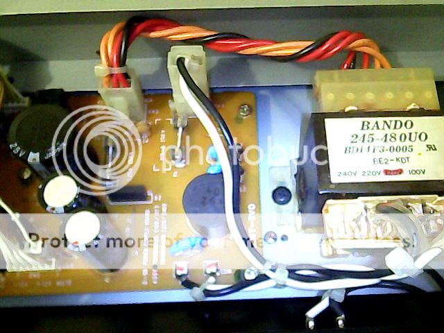

I bought a D-50, but the voltage is changed, it operates at 220v, it was modified ... can anyone help me, showing some internal image of the transformer, because he was converted, and would like to convert to the original voltage, 110V ... if anyone has a schematic image of the transformer or the original, so I could make the change.

I just found someone on the gearslutz website who had the same problem. Here is what he said
Most Rolands are easy- you desolder one clearly marked terminal and solder it to the 110v terminal and change the fuse.
here is the thread that came from.
http://www.gearslutz.com/board/electronic-music-instruments-electronic-music-production/125107-changing-voltage-vintage-synths-220v-110v.html
My suggestion is to open the case up and see if it looks as simple as he says. If you are uncertain, it would be good to take some clear pictures of it, and post them here. I'm sure we can work through it.
Gary

I would like to thank for the tip! I opened the keyboard along with a friend electronics technician, and confirmed what you said, only need to reverse a string, but not have to change the fuse ... the result was this:
The internal energy suply.
Photobucket
After, 220v
Photobucket
Before, 110v
Photobucket
Thank you, so much!!!

PostPosted: Thu Feb 23, 2012 1:02 pm    Post subject: Reply with quote  Mark this post and the followings unread
I think you should still change the fuse.As long as there is one on the primary side of the transformer. If not, do nothing.
It should be twice the Current rating, as you've halved the Voltage.
Stereokromatik
Joined: Feb 21, 2012
Posts: 5
Location: Brazil
PostPosted: Fri Feb 24, 2012 3:20 pm    Post subject: Reply with quote  Mark this post and the followings unread
the first photo, appear two fuses, which were not replaced before the keyboard is converted to 220 ... I think it no need to change now, who is now with the original voltage. Still thanks for the tip Smile))
