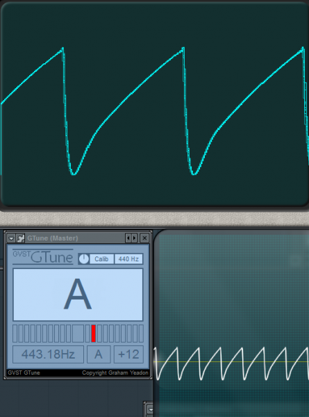

Now. I’m trying to get a clean and straight sawtooth out from an ordinary cmos like the 40106 using a general purpose PNP transistor and a simple RC network. Even if my result isn’t too bad, I’m not completely satisfied with it. The main problem is that the slope is slightly curved, and when I lower the pitch, the curve becomes even more prominent.
My question is; are there any “simple ways” to shape a clean saw from a square wave (or from a triangle for that matter), without involving too many components? Any feedback or pointers appreciated.

Circuit diagram please. I know the standard schmitt based cmos oscillator very well, but I want to see how you have encorporated a transistor.

You would have to linearize the charging time of the capacitor and I have had trouble finding a way to do that, I think there is some way to do it with a constant current source but I'm not sure how, it might remove the ability to change the charge time and thus frequency.
Yes, you'd then change the charge time by changing the current ... if you want to go really minimal ... roughly ... a transistor 's collector current is proportional to it's base current, so changing the base current would change the charge time for a capacitor ... now find a way to discharge the capacitor ... prolly a diode from from the inverting Schmitt trigger out to the capacitor.

Ok, so here's the schematics, all values are tveakable (obviously) but this config gives me the best saw right now. As you can see the slope is curved but there should be a way to straighten it out, I hope Smile

As for that circuit, I thought you said you wanted a simple way to make a sawtooth? Laughing
Here is my sawtooth/ramp VCO circuit (see attachments)
The teeth of the wave do get spaced out at low frequencies, but your circuit exhibits the opposite sort of curve in the rise that mine does.
From most of my experiments my circuit is near totally linear in charge, with only a discrepency below the audio range (when a good capacitor is selected anyway) Also using a faster switching diode makes the vertical part of the wave steeper.

@Cynosure: Yep, that would be the same as a 1680pF cap, if they existed, but I don’t think they do. I drew the schematic just as it looks on my breadboard. I’m really no expert in electronic theory, but I think the effect might differ a little bit if you set up two different caps in parallel due to their individual charging/discharging values, as opposed to a single one. But I might be wrong here, so don't take my word for it.
@JingleJoe . Thanks for the schematic, nice and very clean setup with your op-amp there. I’ll try it out tomorrow.
