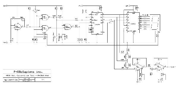

PostPosted: Mon May 07, 2012 4:26 pm    Post subject: more mods
Subject description: circuit pr0n
kvitekp wrote:
I've replaced 9.1V zener with LM4040CIZ-10.0-ND part which is Precision Shunt Voltage Reference
with .1% tolerance and pretty low temperature coefficient (100ppm/C) in TO-92 package.
I'll see if I can locate it somewhere, allthough so far the 7809 seems to work fine for me. It still had the same
voltages when i switched it on today, and I don't have the tools to measure mV's or less anyway. Rolling Eyes
here's what i got sofar: (see schematic at the bottom)
starting on the left side, there's the oscillator. I didn't look at the original schematic when I wired it up,
just selected some values that I think produce a usefull range for testing. I added a cap and a resistor to
the ouput to convert the square into a pulse, this way you can still use the up/down buttons in between steps.
the oscillator is followed by 2 NAND gates which function as 2
voltage controlled switches.
(this is also why I didn't use a 40106). The reason for adding these is so that I can now turn the dot on the display
on with the same switch. Cool I tried a blinking dot to display the oscillator speed but that turned out not
to be very usefull, especially at low step speeds.
Next are the Up/Down switches. U1d is used as a debounce circuit in combination with the 100K and
100nF cap on pin 12. This provides a clean CLK signal when using the Octave Up/Down buttons.
The 22K/47k resistors on the CLK and Up/Down inputs of the 4029 are voltage dividers since it makes
more sense to me to power the oscillator from the 12V line to keep possible noise of the 9V line.
I don't think the 47k resistors to ground are actually necessary but I placed them there just in case.
(haven't tested it yet like this and just noticed the Up/Down pin is either connected to GND or 12V by
a 100K resistor so I'll look into that)
not much to say about how the 4029 is wired except that I used the parallel inputs to create a reset pin.
the 4/8 steps switch is a bit different then in the original schematic. Instead of actually resetting the
counter (which doesn't work when counting backwards) I just tie the 3rd bit to ground. This might produce
a different voltage since actual GND could be slightly different then a low output of the 4029 (?!). But I wasn't
able to measure it.
nothing special about the display driver chip, I used what I had in this case a 4511 CC driver. You can change
the 2K2 resistors to whatever works with the display.
I only used 100K resistors for the R/2R ladder since I find that easier to match and the rest of the circuit is
the part that's still original.
or just keep it simple and use one of these: geek

Dat's a nice schematic, which editor do you use?
Posts: 3914
Audio files: 579
PostPosted: Tue May 08, 2012 5:15 am    Post subject: Reply with quote  Mark this post and the followings unread
the schematic is drawn with ExpressSCH

PostPosted: Sun May 27, 2012 5:15 pm    Post subject: updated schematic Reply with quote  Mark this post and the followings unread
here's an updated schematic with the LM4040DIZ-10V in place, I had to replace the 200k resistor with a
100k aswell for a good range. It's still on breadboard but seems to work fine. Thanks for the suggestion Smile
I also replaced the display driver with one that has a nicer 6 (and 9 but you won't see that).
edit:
Embarassed I noticed 2 errors in the schematic so here's the updated version.
I almost finished it, just have to do some final painting and then I'll post a pic bigsmurf
Modified MFOS oscillator calibration tool
 Filesize:  82.01 KB
 Viewed:  242 Time(s)

PostPosted: Sun Jun 03, 2012 12:29 pm    Post subject: finished build Reply with quote  Mark this post and the followings unread
finished it and posted some pics here
I had to do one final mod because as i expected there's a difference betweeen a direct GND connection
and a low CMOS output. So when switched to 0-3 steps I got a slightly lower voltage then 0-7 steps.
I solved this by connecting 0-3 steps side of the switch to a 1K pot, which has one side wired to GND
and the other side with a 1M series resistor to the 10V reference voltage, instead of directly to GND.
SoundCloud BandCamp Stickney Synthyards Captain Collider
Posts: 2040
PostPosted: Sun Jun 03, 2012 1:25 pm    Post subject: Reply with quote  Mark this post and the followings unread
Cool! Looks awesome. What happens if it's free running and you hit one of the up/down buttons by accident? Wink
Posts: 3914
Audio files: 579
PostPosted: Sun Jun 03, 2012 2:23 pm    Post subject: Reply with quote  Mark this post and the followings unread
with free running I suppose you mean when it steps by means of the oscillator. I designed the circuit so you
can use the buttons just the same. So if it's counting up and you want to go a step back you just press the down button.
(and it will hold as long as you keep the button pressed)
Posts: 2040
PostPosted: Sun Jun 03, 2012 5:41 pm    Post subject: Reply with quote  Mark this post and the followings unread
Cool Smile
Was just a silly question that struck me, but that great. And yeah, by free running I meant oscillator stepping rather than manual stepping.
