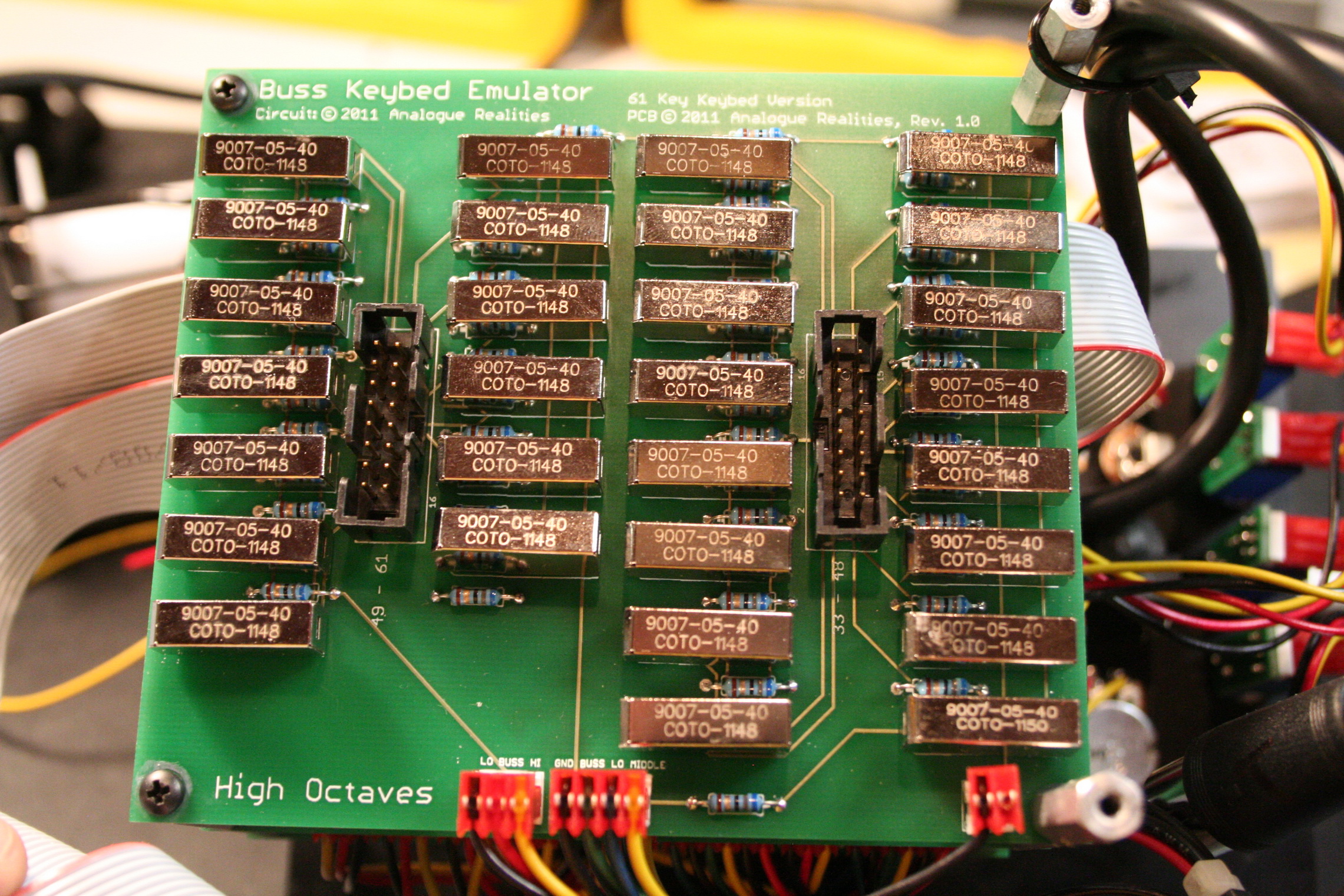

For me, this is the icing on the cake. The first module I built when I first met Nyle and started my project in the mid 1970s was the keyboard. It's somehow fitting I think that the Duophonic Keyboard is the last module for my Synthasystem.
There are pictures on the blog, here: http://analoguerealities.blogspot.com/
I decided on using COTO 9000 series, high sensitivity coil, reed relays to mimic the old Pratt-Read buss keybeds. The high sensitivity coil only draws 5 mA at 5 volts, just right for the Doepfer MTC 64 MIDI to TTL unit. Basically, the MTC 64 takes a note on/off and generates a unique TTL level voltage for that key, and that key alone. So, you turn a MIDI keyboard into a device which can control 64 other things with a single key press. For this module, the MTC 64 turns the relay matrix into a buss type keybed, perfect match.
The blog has more on the features, etc. Let me know if anyone has questions.
Here are a couple of photos.
This is one of two relay PCBs. I had to split them into two due to the size of the relays.
 Filesize:  1.24 MB
