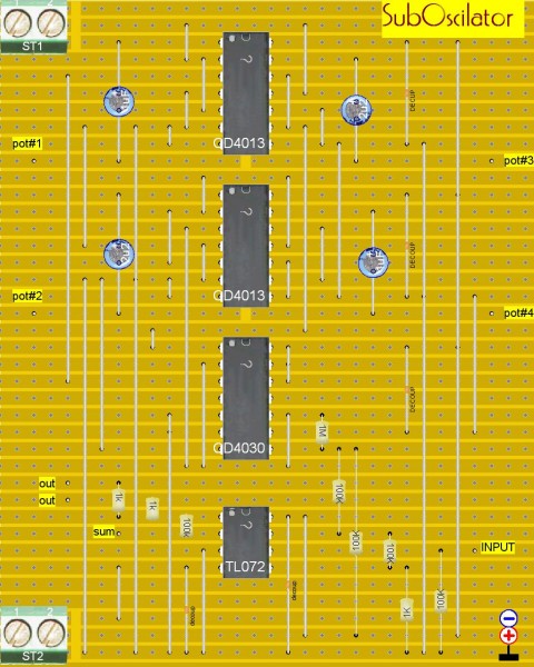

Here's a stripboard layout for the suboctave oscillator / clock divider by Roman Sowa link:http://www.sowa.synth.net/modular/divider.html , i'll be building it this coming week or so and i always check the layout while stuffing but seems ok to me so far..
cheers
you may also add decoupling electrolits on the power rails ,i missed it cause it was obvious to make,also the 120K resistors can be soldered on the pots themselves
(edit: found an error ,seems ok now)
(edit: the fix that i thought i made was an error ,should be ok now)

Roman's frequency divider is a good circuit and works well , i built a quad version with 2 outs per divider in 2009 i think Smile, i mostly use the even division , but the 1.5 & 3 is cool too Smile .
a great circuit .

Thanks Dave ,you sugested this to me i think ,and that 2 outs per division is great idea ,i still haven't build it ,that way i can use it also with clocks low freq ,may modify it in meantime
