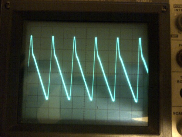

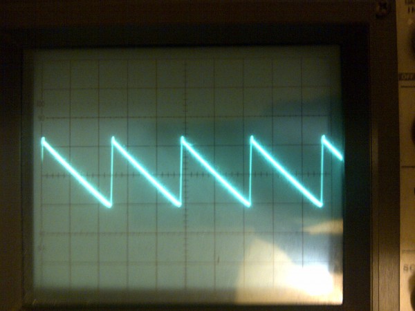

So what happens is I either get nothing or approx 10kHz. This happens when I turn the freq passed 5 (0-5 get nothing, 5-10 get 10kHz). The wave (when visible) does look good, better in fact than a working oscillator, but freq control does nothing and the Saw output looks an odd shape.
Bad oscillator. Pin 5 @10kHz (the only frequency it will produce) Time= 5 micro Seconds per division V=2V per division

Saw output (same freq and oscilloscope settings)
