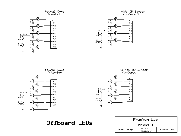

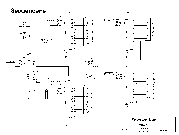

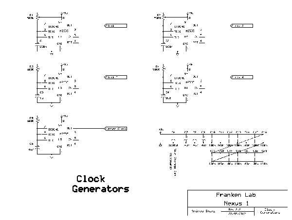

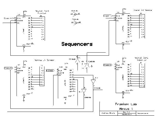

PostPosted: Mon Aug 20, 2012 6:34 am    Post subject: Reply with quote  Mark this post and the followings unread
Here's the schem for the new sequencers.
I'm setting up this default layout, but keep in mind that apart from being hard wired to the clocks, all the other inputs and outputs are SIL strip (some *2), and from there it's all in jumpers. (Apart from the LED arrays, which are also hard wired (now via plugs!))
I've taken the inverted inhibit lines to the secondary sequencers. This way one will follow the other, but I discovered that I could also have this inhibit signal reset the next sequencer in the line.
This way each subgroup of gate events will have the same rhythm each time around. (This too could have exceptions to the rule!)

PostPosted: Mon Aug 20, 2012 7:41 am    Post subject: Reply with quote  Mark this post and the followings unread
Uncle Krunkus wrote:
I'd love to see if this could be put together on the G2 Demo 8)
All of it sketched sofar?
That last bit would have to changed a bit I guess ... G2 has 8 tap binary counters.

PostPosted: Mon Aug 20, 2012 2:48 pm    Post subject: Reply with quote  Mark this post and the followings unread
Couldn't you just use 5 * gate sequencers?
Each with their own clock?

PostPosted: Mon Aug 20, 2012 3:07 pm    Post subject: Reply with quote  Mark this post and the followings unread
Ah it is a ring counter I see now, not binary - yeah a sequencer would do it then.

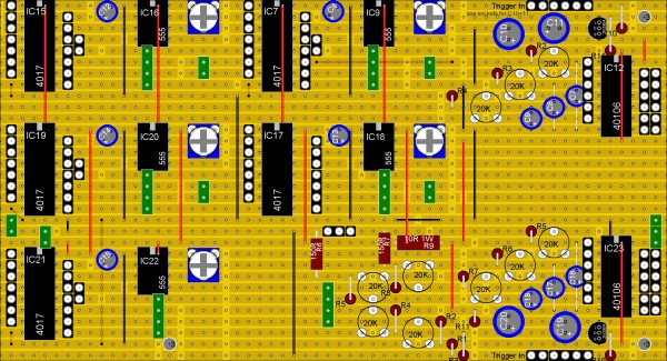

PostPosted: Sat Aug 25, 2012 3:46 am    Post subject: Reply with quote  Mark this post and the followings unread
Here's a rough idea of the stripboard.
DO NOT BUILD THIS!!!
It's still got heaps of errors. (maybe you can find one?)
It's actually quite hard drawing a board which has already been built. All the kludges have to be adjusted if anyone else is ever going to build it.
But the thing I wanted to show was how it's turning out to be quite a good "medium" level Lunetta Project. I never thought it would go this far !! LOL!?!
The brand new part is the RHS 30%, which is mainly two starved 40106 oscillators, each with their own storage caps, pre, and post transistor.
Can give this a once over Joe, and let me know if there's any obvious fault there. I'm hoping I can squeeze a hex exclusive OR between the two, as this would be a good mixer. All re-patchable to some other use of course.
BTW All resistances being equal, will halving the capacitor double the frequency, on a simple schmitt trigger inverter oscillator?

PostPosted: Sun Aug 26, 2012 12:33 am    Post subject: Reply with quote  Mark this post and the followings unread
Yes, C11 was back to front. Fixed.

PostPosted: Wed Sep 05, 2012 7:14 pm    Post subject: Reply with quote  Mark this post and the followings unread
I did heaps of work on the stripboard, and installed the inverters, XORs and one of the two oscillators. Then I tried testing, and all the LEDs were stuck on one output! Crying or Very sad
I couldn't work out what had changed, as the LEDs were working fine.
Then I realised that in all the work I'd done on the old part of the circuit, I'd inadvertantly removed theonly bypass cap which had been installed on the original! Shocked Add to that an extra 4 chips, and,... sorry captin, she canny take no more! We've got stray capacitance and bogus resets in RED ZONE PROXIMITY!!! Surprised
Needless to say, the job right now is installing 3 * 10uF electrolytics on the main branches, and a 100nF on the solder side of every chip. I've used greencaps, cos they look like big green bugs crawling around under the board! Cool Laughing
Oh, and here is a look at the stripboard at this stage. It's still not finished, but it's all in the right neighbourhood. Part numbers are completely wrong.
 Filesize:  689.12 KB

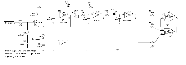

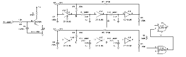

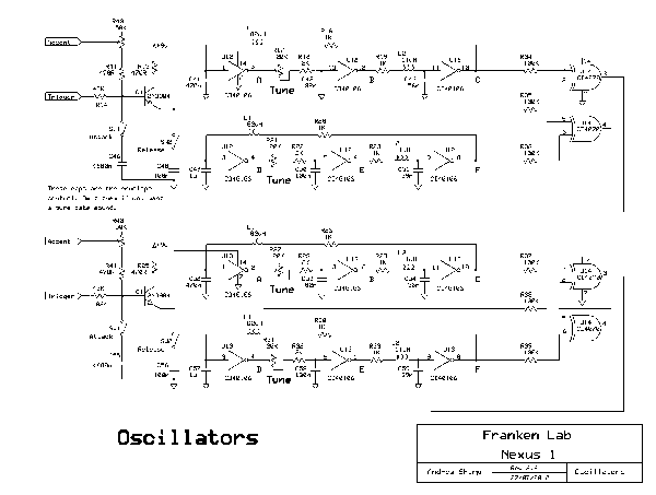

PostPosted: Sat Sep 29, 2012 2:57 am    Post subject: Reply with quote  Mark this post and the followings unread
Here's the idea for the oscillators.
The third XOR input could go to points B, C or D instead of A, depending on the delay (phase) relationship you want. Initially I couldn't get it to start at all, then I added the 100K around the first stage on each group of three. That got it going straight away. There is definitely a phase shift between the stages, possibly even a feedback effect which changes the tuning quite radically. At one stage, turning up the frequency actually dropped the tuning! Confused Cool
Does anyone have any ideas about this? How to improve it? Any problems?

PostPosted: Sun Sep 30, 2012 3:16 am    Post subject: Reply with quote  Mark this post and the followings unread
hmm thats a nice odd one, did you try making that 470 ohm resistor larger instead of adding that 100k resistor? or both?

Okay,
Here is the oscillator (half a 40106) as I have it set up right now.
Before anyone says anything about these inductors doing virtually nothing, I know, they were all I had at the time that was easy to stick in! I'm actually thinking this could be a great place for an 8R/1K transformer! (argh!! feature creep!!!!)
Anyway, I've looked at and listened to it both ways, and it's better with them in.
There's great phase differences between the A-F pickup points, (up to 90deg quite easily at higher frequencies) but I must admit I haven't got the XOR hanging off it yet. When I hook it up, everything goes dead. Is 100-300K a good size going out? Do I need pull-down resistors? Earth all the other inputs? (BTW I got a great random modulation by leaving one which I wasn't using floating!! Smile )
 Filesize:  14.93 KB
 Viewed:  51 Time(s)

PostPosted: Wed Oct 10, 2012 7:37 pm    Post subject: Reply with quote  Mark this post and the followings unread
Here's all the schems so far.
I'll use this as the place to get the latest ones.
Designators should be all fixed now, so let me know if there's anything amiss.
 Filesize:  35.1 KB
 Viewed:  40 Time(s)
 Filesize:  46.25 KB
 Viewed:  36 Time(s)
 Filesize:  36.38 KB
 Viewed:  36 Time(s)
 Filesize:  49.22 KB
 Viewed:  42 Time(s)
