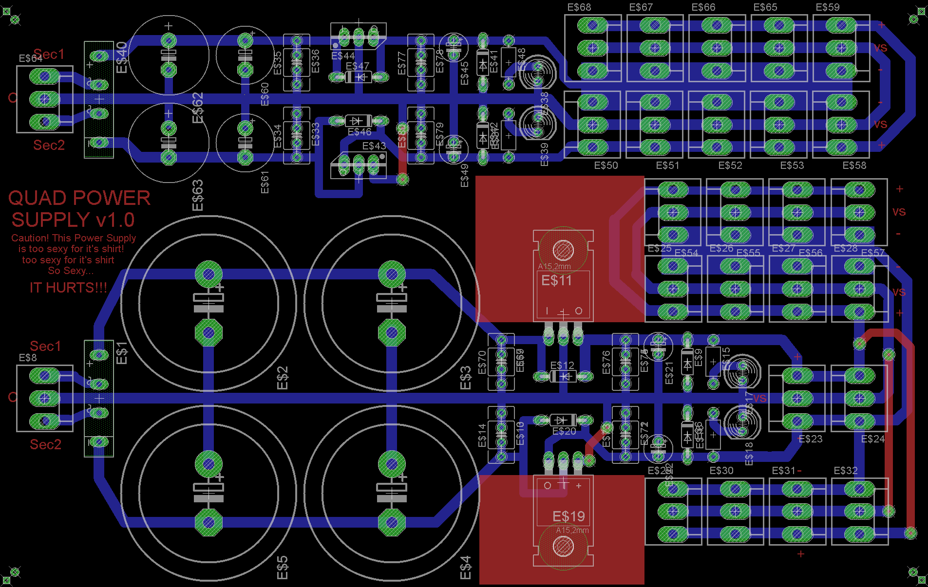

I am using a power supply I built myself. It is actually two isolated power supplies on one board, the smaller one is driven by a smaller (and seperate) transformer. I have actually thought about using a normally open relay on the negative rail so that the positve rail must start first and this will cause a small delay before the relay is closed and the negative rail is powered up. Here is a quick view of said power supply:
this psu provides bipolar 5v and bipolar 15v
