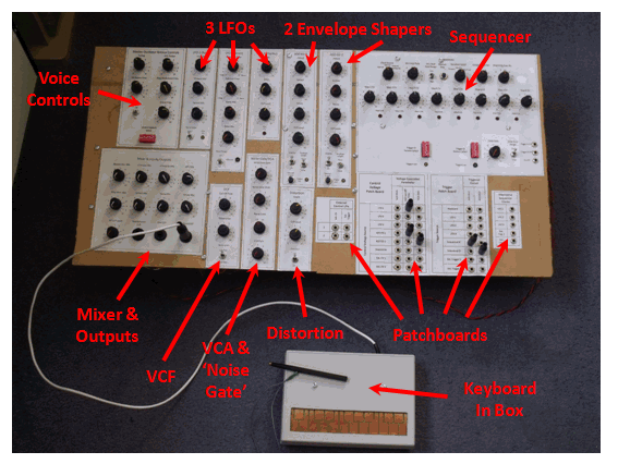

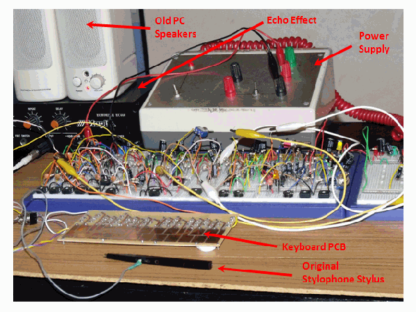

As Promised, here are some pics. The first shows the front panel with its various controls, the second shows the rear of the panel and its PCBs and the third is at some stage of breadboarding. This is not the final build! It is simply a piece of hardboard which is temporarily holding everything together. Note that I'm using 3.5mm jack sockets for the patchboard. I use a shorted 3.5mm jack plug to connect various parts of the circuit together (I did the same on my flightcase synth).
I'll give a proper description of what is what and some sound recordings soon. It's taking me a little while to master the forum interface (I am a forum virgin you see).
Gary

Hello again and thanks for the welcomes that I got from you.
When I was building my flightcase synth, I came across lots of other circuits that I wanted to try out at some stage, some of which fell under the Lunetta category. As I said earlier, this project started out as a simple Stylophone clone idea, but I then started to add circuits to it and it all began to mushroom. I used a 555 design for the master oscillator, so I then thought about adding an APC circuit to it. It all grew from there.
The boards shown on the earlier photographs contain the following circuits:
Voices Board:
A master oscillator (half a 556)
An octave divider giving -1 and -2 octaves (4024 driven by the master oscillator)
An APC (the other half of the 556 driven by the master oscillator)
A ring modulator (a 4011 type driven by the master oscillator, with a modulation oscillator based on another half a 4011)
A user defined waveform generator (UDWG, based on 4017 and DIL switch, driven by the master oscillator)
A white noise generator (reverse biased NPN base-emitter junction type)
A drone oscillator (the other half of a 4011)
This gives 8 voices in all.
Sound Processing Board:
A LP/BP VCF (using both halves of an LM13700)
A VCA (half an LM13700)
A ‘noise gate’ (the other half of the LM13700)
A distortion unit (based on an NE5534)
The noise gate is sometimes required when using the keyboard. The stylophone operation switches the master oscillator on and off (along with the octave divider, APC and UDWG which are fed from it), but the RM modulation oscillator, drone and white noise are constant (if they are mixed in). The noise gate switches all outputs off when the stylus is not touching the PCB keyboard.
LFOs Board:
LFO 1, a fairly standard mixable square/triangle LFO (using an LM324)
LFO 2, based on an old siren circuit giving mixable pulse and ramp outputs, where the rise/high and fall/low times can be separately controlled (LM324 and CA3140)
LFO 3, a version of Ken Stone’s Psycho LFO, but using all six oscillators of a 40106 (plus the LM358)
Envelopes Board:
2 identical ASD envelope shapers (using a 556 and an LM324)
Mixer/Outputs Board:
Mixes the 8 voices (using an LM358) and has a separate line amp (NE5534) and headphone amp (LM386).
Sequencer Boards:
An 8-step sequencer, which can run forwards, backwards or in a ping-pong fashion. Additionally, the forward and ping-pong step length can be changed (not backwards currently, as that seemed too complicated at the time). This is by far the most complex part of the unit (using a 556, a 4029, a 4051, a 4013, a ULN2803, a 4081 and 2 x 4066). It has its own clock, but can also be manually stepped, or an external clock can be used (including any of the LFOs). In addition to CV outputs, it has two trigger pattern generators, using DIL switches, which can be used to operate the two envelope shapers.
The two mp3 files show a little of what it can do. Heterodyne Thing 2 is simply a noise making exercise. Percussive Tune 1 uses the keyboard and sequencer together to produce a 'tune' (the first thing that came into my head really - it's not meant to be a work of art). I used no other effects or overdubbing on these (although I did a fade in and out on Heterodyne Thing 2). See what you think.
Gary

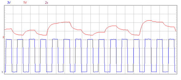

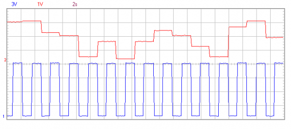

Hello Again.
I've finally got round to work on the circuit to randomize my sequencer (despite coming down with a bit of "man-flu" ). I thought that it would also be nice to generate a random CV from it as well, using an R/2R ladder. The schematic is shown below (based heavily on RingMad's 4006/4077 design - thanks again for that).
As you can see from my scope traces, the design seems to be working well (red trace = CV, blue trace = clock). However, I seem to be suffering from RingMad's original problem, i.e. that the thing keeps locking up, despite the addition of the pull-down resistor on pin 3 of the 4077 (as shown). The lock up occurs on power up and I have to switch it off then on again (sometimes several times) before it works. I've tried changing the value of the pull-down resistor, changing which output it's on and putting them on all four outputs, but to no avail. I've also tried changing the 4006 and 4077 chips, but again, nothing cures it. By the way, the problem occurs whether or not the 4077 is attached to the rest of the circuit.
I wonder if anyone can think of a reason/cure for this problem? Also, does it matter which 3 of the 4 4077 outputs I need to connect to pins 9-11 of the 4051 in my sequencer (see ? on the schematic). I guess that as it is randomness that I want, it doesn't really matter.
In case you're wondering about the 27K on the CV output, that's down to my "VCO" being a bit crap, so I have to keep the CV down to a maximum of about 3.5V.
No sound samples yet, as I haven't connected it up to the sequencer, but as soon as I do, I'll post the results.

Are you sure this thing is latching up and not powering on in a steady state condition? If all of the 4006 shift register stages are high, the outputs of the 4077 will be high too, so nothing can change. There may be other steady state conditions as well so for a sanity check, look at the output values when it appears it is not working and make sure the inputs can actually change. I read RingMad's comments about it latching up with a high frequency clock and that's the classic description of a shift register feedback design that has steady state conditions; the circuit isn't latching up, it's just running through all possible states faster until it reaches a steady state. Is the clock input floating at any time? That could cause problems that could be solved with a pull-up or pull-down resistor.
One unrelated observation, the terminating resistor in an R2R ladder is 2R.
