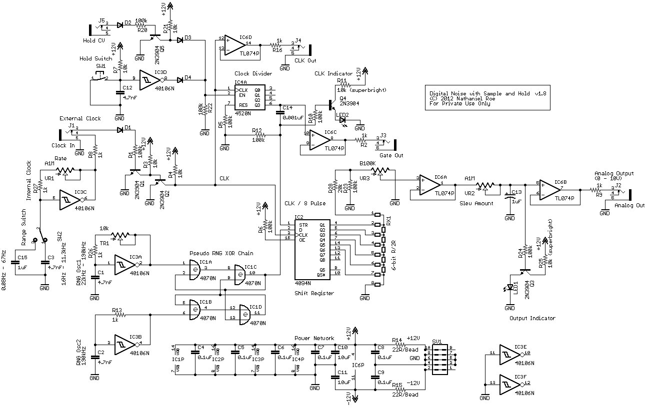

I designed a CMOS-based noise generator/sample & hold, and I think it makes sense to share it here. I used a couple CD40106 oscillators to drive an XOR chain as a digital noise source, and then I clock these random bits into a double-buffered shift register. Every 8 bits, I strobe the shift register (pushing the back buffer to the front) and the front side of the shift register outputs bits into an R/2R ladder to convert 8 bits to an analog value. This is buffered and optionally slewed.

thank you corex!
I actually hadn't looked at any real Sample & Hold circuits. now i will! Wink
don't have any sort of registers among my chips atm, but see various kinds pop up in quite a variety of circuits... may have to get me some at one point, eventually, i guess.
still wondering what use I could put those 4042s to (in a lunetta environment)...
well, live, learn and occasionally just go back to the schmidt-trigger...Smile

You can build a shift register with latches:
You would need two 4042 in place of the 4094.
