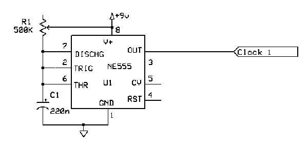

PostPosted: Sun Nov 04, 2012 3:21 pm    Post subject: 555s in focus
Subject description: Getting low->audio freq clks from astables
In the Nexus 1 thread here
http://electro-music.com/forum/topic-54532.html
I'm trying to refine an old build from a time when I didn't know half as much about 555s, CMOS, and audio electronics in general, as I do now. ( Which only half as much as I'd like to know, which is only half as much as some already know, etc. etc! Laughing )
Anyway, I'd like to fix up these 5 * 555 clock sources. Especially, get them running faster and more stable. I do still need them to be easily set at really low frequencies too, so maybe I'll need a cap switch. (hope not, no space left really! Embarassed Laughing )
At the moment, I can only get them to about 20-50hz before they lock up and don't oscillate at all. The schem shows where it's at.
I could add a resistor and a diode to widen the pulse width, would that help?
What about that 10-100nF cap which often hangs off pin5 (CV) to ground? That has a stabilising effect on the frequency dosen't it? Should I add them?
I know they are all NE555 types at the moment, but I want to change them all to LC555s once they are set up better. Then I'll be able to get a current reading before and after, which would be interesting to see. I hope the frequencies wouldn't change with CMOS, as the RC concept is the same either way, hey?
Anyone got ideas?

Hi there,
I've been looking at this and putting your component values into my my 555 spreadsheet. The trouble is that the normal astable calculations have to have a value for the 2nd resistor been pins 2/6 and 7. If you put in zero (which you've effectively done) the spreadsheet say "does not compute" as it has to divide by zero (which gives a meaningless answer).
What sort of frequency range (max/min) do you want to get from this circuit? That will help me to work on the best solution. It would definitely involve a resistor between pins 2/6 and 7 and probably another small one between pin 7 and your pot. The diode(s) might not be needed, depending on how narrow a pulse (or wide a pulse) can clock your other circuits.
I would also add the 10nF cap between pin 5 and 0V and I always connect pin 4 to pin 8 (V+ rail) in such astables (although I get much the same result with pin 4 not connected). You may need the dreaded cap switch pot if the total range is too large for 1 capacitor.
Let me know want you are aiming for and I should be able to work something out. I can also explain the calculations used.

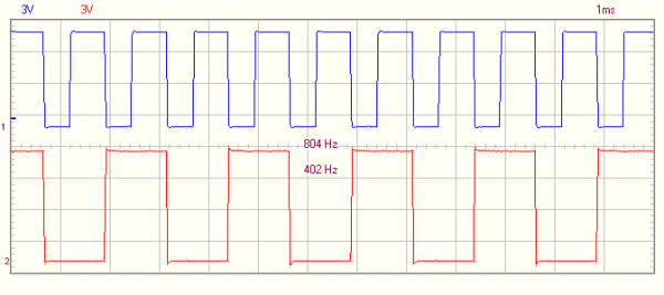

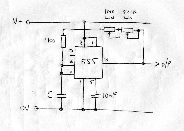

PostPosted: Mon Nov 05, 2012 5:35 pm    Post subject: New Idea? Reply with quote  Mark this post and the followings unread
I've tried a different approach to this problem and I've had better results. The circuit below has a different (and simpler) arrangement to the "normal" astable (note that pin 7 is not connected to anything). Also, I haven't shown any supply decoupling capacitors here. It has the advantage that the duty cycle doesn't change much with frequency. I've still needed to add a second pot for the fine tuning (the 220K lin - I just happened to have one at hand, you could try a 100K). Officially, the frequency is given by:
f = 1/(1.44 x R x C)
R will be the sum of all 3 resistances between pins 2/6 and pin 3. My actual measured values did not agree exactly with this, but were in the same ball-park. They also seemed to vary somewhat with supply voltage (I can't remember the voltage that you plan to use). With a 12V supply, I got the following results:
If C = 100nF, f = 8.9Hz to 11.2kHz
I C = 1uF, f = 0.46Hz to 635Hz
The duty cycle ranged from about 54% to 60% (that is the signal level was high for 54-60% of the time for each high-low cycle). The tuning was still a bit fiddly, but was much easier than my attempts on the original astable design. To get from 0.5Hz to 8kHz, you would need switching in the current set-up.
I also checked that the output was OK for CMOS, so I used a 4024 to half the frequency. I did this at two different 555 frequencies and it worked well (see traces attached). You can see that at the higher frequency, the waveform gets a little out of shape, but this is common at higher squarewave frequencies. The important thing is that in both cases, the 4024 successfully halved the original signal frequency.
You might like to play with this circuit yourself and see what you think, but I think that it is more promising than the original idea.

Sorry about the delay in replying. I only noticed your new updated request very late last night. I've checked your figures and they seem to agree with my calculator. There are some very small differences, but that's due to the fact that I've used the natural log of 2 in my calculator (ln2 ~ 0.693, 1/ln2 ~ 1.44).
I took a slightly different approach, keeping the timing capacitor value constant, as you can see by the table below. My R1 (which is not used at all) could be added to get the 1uF values to fall below 1Hz (your lower end requirement). The duty cycle values (DC on the table) do get rather large, but JingleJoe assured me that this would not be a problem in triggering a CMOS circuit (I was going to try it out as a sanity check, but I haven't got round to it yet).
By the way, if anyone disagrees with my duty cycle calculations, it may be because the datasheet definition give the % output low figure. When I measure it (on my multimeter or scope) it gives the % high figure, which is the figure I've given. I think that it might be down to a subtlety of the definition of duty cycle which (I think) is the proportion of time that the device is under load (I'm sure someone out there knows the answer to this).
Anyway, I hope this helps.
Gary
P.S. I looked up where you live on Google Maps and it seems a good deal more picturesque than Aldershot!
WARNING!!!!
I thought that there was a good reason for R1 on my diagram (I usually put in a small fixed resistor here). If you don't add this resistor (a) the 555 stops oscillating at one end of VR1 and (b) the chip gets hot and will eventually expire! This is because you are connecting pin 7 directly to the positive rail. I'm going to do some re-calculations with a small value of R1 and I'll post them later.
I have now amended the diagram and have a 100R resistor in each R1 position. pale I've also measured all the values to see how they compare. I've used only E12 resistors, obviously you could get a bit closer with E24 values. I've also reversed the DC columns, because the maximum pulse width occurs at the minimum frequency.
I hope that you haven't blown up any 555s yet. This may have been the problem with your original design. I haven't tried TS555CNs or 7555s yet, but I suspect that they will give similar results.

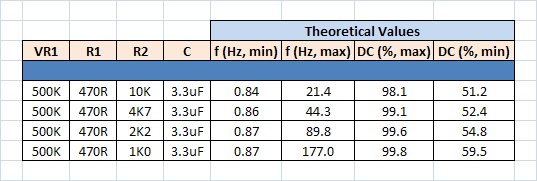

PostPosted: Thu Nov 08, 2012 6:43 am    Post subject: 500K Astable Table Reply with quote  Mark this post and the followings unread
OK. The attached table is for your 500K setup. The capacitances have to be larger to get the right range, so I've done them at 3.2uF and 4.4uF (I assume that you're putting in 2 capacitors in parallel here).
I had a bit of an issue with Bill Bowden's calculator. I said that it differed a bit with my figures, but the difference was slightly too much, so I assumed that I'd got something wrong. I did some long-hand calculations, which agreed with my spreadsheet. I then tried a couple of other website calculators and again, they agreed with my figures. I'm not sure what's going on there. This is one of those that agreed with me:
http://www.ohmslawcalculator.com/555_astable.php
I haven't got round to checking these figures on a breadboard yet, but they should be about right. Again, I've chosen E12 resistors (mainly because I've got them), but you might want to try E24 values if mine aren't close enough.
UPDATE: I've now done the breadboarding and added the results to the table. The 3.2uF frequency figures came out a bit higher than expected, but it might have just been that a capacitor was a bit on the low side of its tolerance range (or possibly outside it).
Gary

Posts: 4742
Audio files: 51
PostPosted: Fri Nov 09, 2012 12:41 am    Post subject: Reply with quote  Mark this post and the followings unread
Man,
Thanks heaps for that last table, it will basically become my bible for a little while! Laughing
Really good figures.
I think I have all the knowledge I need to start the operation, but I'm procrastinating at the moment. Oh, and I need to actually get the 1M trimmers.

I'm gonna go in soon, maybe tonight, maybe LOTRO. Embarassed
I have to re-build 5 * 555 oscillators, in situ,....hmmm
Can you tell that I'm feeling lazy?
Must be these pain killers I'm on for my back. There was the pos. side effects of lethargy and the loss of concentration. So I shouldn't beat myself up too much hey?
Oh, I forgot to mention the master clock. It's 4017 inhibits these four in sequence. Same deal, just needs to run about 8 times slower. So I assume we triple the cap value? 8=2^3 yeah?

It's funny that you should mention bad backs, as I'm also suffering at the moment (currently without painkillers Crying or Very sad ). And I certainly go through lazy periods (or can't-be-arsed periods as we Brits might say).
I might need a bit of clarification here. You say that your master oscillator need to be 8 times slower than the others. Do you mean starting at about 0.125Hz? What does the upper limit need to be? Also, I'm a bit confused by your 3 capacitor comment (unless I've got completely the wrong end of the stick, which is quite possible). The frequency of the astable is inversely proportional to the timing capacitor, so (all other things being equal) this would mean that the capacitor needs to be 8 times the value. This would probably have to be a tantalum bead type, as normal electrolytics are not recommended for timing (unless you want to put up to 8 non-polarised capacitors in parallel!). The other possibility (of increasing the resistance) is not really viable, as we're already using a 1M0 pot and if you raise R1 and/or R2 (in my diagram) it begins to severely limit the tuning range.
Just to give you an idea, I have put a 22uF capacitor (C1) and 6K8 resistor (R2) into my calculator (still with VR1 = 500K and R1 = 100R) and I get a frequency range of 0.128Hz to 4.79Hz.
As for your other post (about the WSG filter) it's not something I know vast amounts about, but I'll certainly try to help!
I'll leave you to your LOTRO now (are you Gandalf?). Looking forward to the release of the Hobbit film. They've just opened a new cinema in Aldershot (we haven't had one for several years) and I've only seen the outside of it so far.
Gary.
Addendum
I've added yet another table, with a 470R resistor replacing the 100R one. I was a little concerned that although the 555 seemed fine, the resistor felt a bit hot. After measuring the current through it, I realised I was exceeding 0.25W - not a good idea. With the 470R resistor, it's now at about 73mW, so it should easily be OK.
Actually, reading your Nexus 1 thread, I noticed that JingleJoe had already mentioned that you needed a resistor here to stop the 555 from dying. He also suggests putting the pot between pins 6 & 7, so that the duty cycle doesn't change as much - I'll have to try that as well now...
I've also been playing with the WSG Oddness filter, just so that I can make (semi-)informed comments about it, when necessary.

I just noticed on that last table (as I'm building it) it contains 3.2uFs, when the E12(?) series only has 3.3uFs. Which did you use? Cos I can't find 3.2s. Not sure if that would change the other values, or not.

Ah yes! Because you had mentioned 4.4uF in an earlier post, I assumed that you were using 2 x 2.2uF capacitors in parallel, so I used 3.2uF which is a 1uF and a 2.2uF in parallel. If you have a 3.3uF, that should give similar results. The problem with capacitors is, due to their wide tolerances, they're not so easy to find in the E12 series values (i.e. multiples of 1.0, 1.2, 1.5, 1.8, 2.2, 2.7, 3.3, 3.9, 4.7, 5.6, 6.8 and 8.2). Sometimes, you can only get E3 values, which are are a subset of the above (1.0, 2.2 and 4.7 or possibly 1.0, 2.0 and 5.0). God, this is tedious to type - I hope that's it's not as tedious to read...
Gary
Additional (& apology)
I've just added a theoretical values table with optimum values of R2 for a 3.3uF capacitor. The apology is that I've realised that I'd made a typo in the previous table - C should have read 3.2uF for all of the top part and not have 2.2uF in the 2nd and 3rd line. Table is now corrected. I hope that you haven't already soldered in the 2.2uFs.
 Filesize:  31.48 KB
 Viewed:  2769 Time(s)

Nah, I finished the first one, but I went 3u3 tantalum anyway. Cool
BTW I didn't even know which E series I was on about! The one I should have said was the E6 series. E12 generally kicks in about 820n with MKTs.
