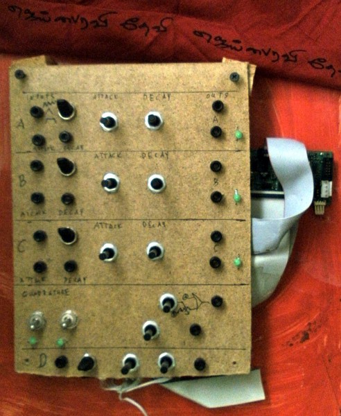

The Triple Function Generator (with testing section to daisy chain a second board).
This was before I started using plastic for test panels.
