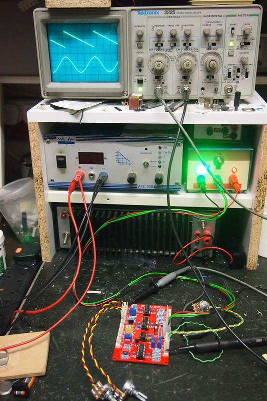

Oh, and I forgot: Another two are alive! A smooth build, once I found the errata notes. I used 100K trimmers for sine round, and got an easy +/-5V
One though for Fonik - could you think of leaving a larger footprint area, with perhaps multiple pinouts, (as the late Jurgen Haible did on his PCBs), for the timing caps. I have a lot of High quality 2n2 polystyrenes, (and yes - I will give batches of then out for postage), but I couldn't get them to fit. I just squeezed some 2n2 polypropylenes I had in stock into place, and I will try the COG's in future, but I think a little more flexibility in the capacitor area would be a good idea. There was plenty of PCB real-estate left. The capacitor footprint Jurgen used is no way unique or copyright, so there would be no problem in just 'lifting' it. I'm sure the man would be smiling down his approval if you did, anyway.
A minor point really. My thanks again to Thomas Henry and Fonik for a really nice VCO with a massive range., and a very easy build.
Note for other builders on transistor matching: I tested 2n3906's from a bag of 100 bought from 'Rapid' I was able to get 4 with gains identical out of 20 or so tested, and the maximum gain variation I read was +/- 10 on a nominal 230 median value. I think just using two from the same manufacturer and date code would be fine.
