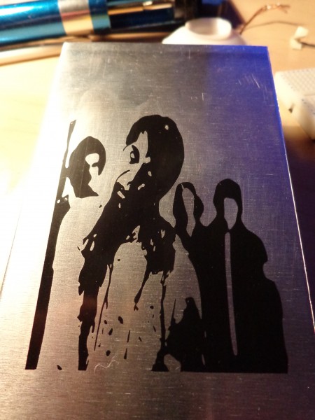

I was messing around yesterday and thought I would try toner transfer for panel designs. Checkout my test run. Its the same process I use for PCB's. I used a spare panel I had left over, It had on one side a protective plastic coating. I peeled this off and applied the toner without going through any of the usual steps (acetone,scouring).
Its works really well like. I'm pretty surprised.
The only thing to figure out know is how to protect the transfer. Its pretty resilient but you can damage it. Does anyone have any suggestions?
I'm thinking clear lacquer of some sort. Or maybe clear plastic ( I'm not sure if I'm to keen on that).
Bonus points if you know what the image is from

looks good, I was gonna try that..glad it works. I've used wilko's clear enamel lacquer from a can it worked ok and covered some rub on lettering (letra-set?) it set nice and hard but but ended up with a 'crazed' effect..which I quite liked anyways.
p.s. its the pilot from dawn of the dead coming out the elevator Very Happy

straight PVA glue
clear , hardwearing matt finish and really really cheap
use a roller gives a light texture to the finish .

The only problem with the PVA glue is you wouldn't want to get it wet.
I'd be spraying them with a good quality can of clear coat. The type you get from a car accessory store.

generally PVA's these days are stable enough , unless your planning on immersing them for a few hours, certainly after about a week of drying they will handle the odd wipe with a damp sponge for cleaning.
About spray on laquers , I tried more than a few, both acrylic and enamels, the best was nitrocelulose and that was 50-50 if it came out acceptably or not, after that i went to PVA and never looked back.

ive done this on quite a few modules and i've had good success with clear enamel spray paint.
