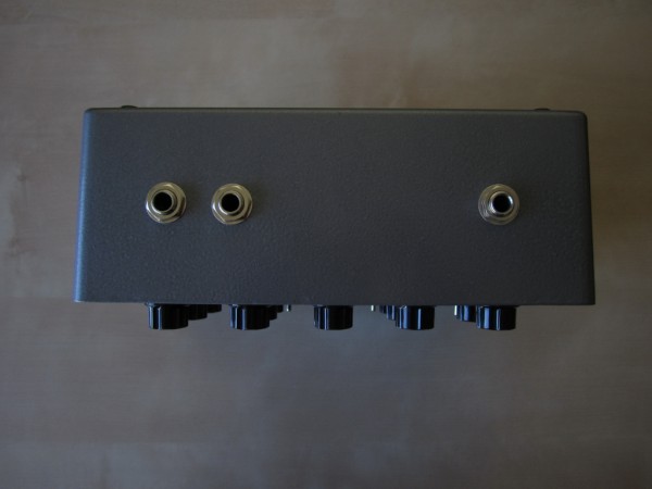

sndbyte
Joined: Jun 26, 2009
Posts: 119
Location: sf
PostPosted: Wed Sep 04, 2013 6:40 pm    Post subject: Reply with quote  Mark this post and the followings unread
Thanks for the comments. Here are some more photos so you can see the in/outputs.
The case is a plastic case I purchased at Radio Shack with an aluminum faceplate. I painted the case with a grey hammered metal spray paint. The panel design was done on my computer using LibreOffice (draw) and printed on cardstock. I then glued the paper design to the faceplate and sealed it with a clear matte acrylic spray.
