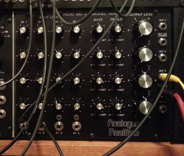

I thought this module would be a fun clone. I did it as a 5U module following the Synthesizers.com panel specification. It's big for what it does, but I think it's comparable to the Moog panel. Mine is 5 units wide. You'll see I use 1/8 inch jacks for the inputs because this is going to sit in my Synthasystem racks, and they are all 1/8 inch. I used 1/4 jacks on the output to make it easier to connect to my audio interface. I added an OpAmp in the output stage that can be switched in or out with a DPDT DIP switch, or hard wired in or out so I can bring the output levels up to the levels in my Synthasystem. Otherwise, it is a faithful reproduction of the original.
I changed the panel somewhat from the original MOOG panel but not dramatically.
It takes 4 PCBs, but they are pretty simple. If anyone is interested in more info or you want to buy some PCBs, send me an email or PM. Unfortunately, there is a lot of wasted space on the PCBs and so the price per PCB is a little jacked up, but I think in quantities, they won't be too bad. There aren't really any odd parts in it, three 2N2926 transistors, but there are several cross matches and Cricklewood or Dalbani/Nikko have them in stock. There are a couple of odd value electrolytics, but you can just get the closest value and it should be fine. I laid it out to use Alpha PCB mounted pots, but others may fit.
I need to build first it to make sure it works, but the simulations I ran seem fine. I just ordered a panel and prototype PCBs. I should have it built in a month or so.
As soon as I'm convinced it all fits and works, I'll post the schematic and FPD panel file.

Thanks. After some consternation, I've got it all working. I eliminated any modifications, like the opamp on the output. The prototype works well and has that nice asymmetric distortion when the signal is just a little hot.

All done and I love it. However, I'm either not as dextrous as you Mosc, most likely, or the knobs are a little too far apart. I can't quite do the panning thing, but practice makes perfect...
