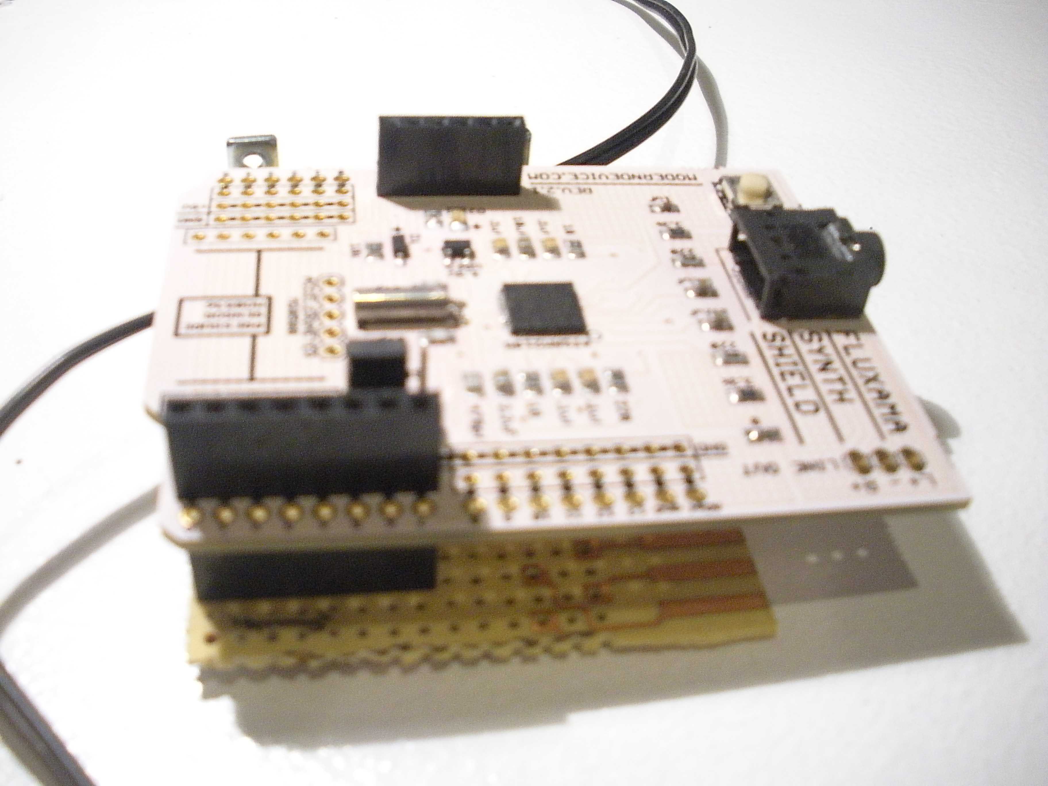

Hello group. It's been a while since my last project, but I finally have a new one to present. Since work on the original GM Voice, ( http://electro-music.com/forum/topic-21634.html ),I've been on constant outlook for other boards and chips to use for upgrades to the project. Let's face it, the GM Voice is currently dependent on boards made in the 90's shipping from a couple guys in China. There's no telling how long these will be available. Lately, there have been a couple of newer GM synth chips out there intended for use in mobile phones. I found the SAM2195 chip which looks like a really good update candidate. It has 64 voices and built in effects. On the downside, they aren't DIY friendly. Besides being SMD, they are extremely tiny. It would be difficult for most DIYers to use as is.
Fortunately, there is a company called Modern Devices which makes a product called the Fluxamasynth. Yeah, not a great name, but who cares if it works? The original intent of the Fluxamasynth is to act as an Arduino shield, however with a simple circuit addition, it's possible to create a new updated GM Voice to use as a standalone midi product.
Here's the Bill Of Materials:
Qty 1 5volt power supply
Qty 1 Fluxamasynth board ( http://moderndevice.com/product/fluxamasynth-shield/ )
Qty 1 Midi connector
Qty 1 8 pin DIN socket
Qty 1 1N914 small signal diode
Qty 1 220 ohm 1/4W resistor
Qty 2 390 ohm ¼ W resistor
Qty 1 LED (your choice of color)
Qty 1 perfboard (or you can make a pcb)
Your choice of panel or case and mounting hardware
A few wire scraps
Optional stereo audio taper 10-100K pot for manual output volume adjustments
That's it! It's embarrassingly short and simple. This barely qualifies as DIY in my book. You'll probably spend more time on the case/mounting panel than the electronics.
Sound-wise, it's quite good, in my opinion. I think I still like my db50xg boards a little better but that may be just a personal choice.
if you look carefully you'll see I accidentally wired the +5V power supply to the +5V Flux pin instead of the Vin pin!

here's what the 2 boards look like together

I just submitted an updated schematic. I have added a fourth resistor to the interface circuit. Pin 7 really needs a pull down resistor to keep from getting stuck notes on dense midi file playback. In this case, I used a 10K ohm.

Yeah Matthias, I wish I hadn't built my panel so fast. I would've had the channel filter built in. OTOH, I have a Yamaha db50XG version of the GM voice which can use the standalone Channel Filter.
Another thought if you build with the Channel Filter: use a switch to select from the raw midi in or the Channel Filter out. That way it can function as a single channel voice or a 16 channel synth for midi file playback.
