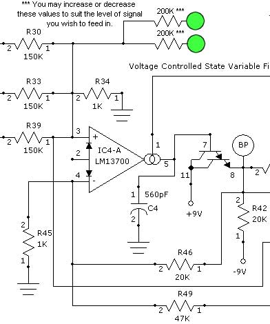

I'm wondering if anyone has any pointers on adding an audio in socket for the filter/vca section. I'd like to be able to run audio through the filter and vca, and possibly use it as a modulation source for osc pitch/filter cutoff. Any ideas?? I haven't built the patched out version, just the switch one. I take it I'd need to add another knob to the mixer section, and possibly expand the mixer circuitry to accomodate the extra audio in...?

... so, here it is the shot:
connect an audio signal trought a 2.2k resistor to R47 (pin 2 side) and the other pole to the ground. I've tried with a cd player for long time without damages on the circuits! The audio signal can be processed by LFO, A-R ENV.GEN. and VCF. If you want to limit the signal in, connect a 100k potenziometer to the 2.2k resistor. I'm not an expert in electronic so I'm not really sure that is the right way do it but it works! ... maybe Ray could confirm us better way or not.

PostPosted: Fri May 20, 2005 1:50 am    Post subject: Reply with quote  Mark this post and the followings unread
now if we look carefully at Rays schematics for Patched Sound Lab
the signal in spot is marked. through 200K resistor but a 100K + 100K potentiometer should work well
http://www.musicfromouterspace.com/analogsynth/SOUNDLABMINISYNTH/SoundLabMods.html

PostPosted: Fri May 20, 2005 3:03 am    Post subject: Reply with quote  Mark this post and the followings unread
... yes, it should be the same input I figured out for audio signal Embarassed
gotcha

Chrometuna wrote:
Ive fed audio (From a CD player) into this input. It comes back out just like it goes in. Unchanged.
Is it supposed to do this? Whats the point?
I think it DOES get a little whickywhacky but not anything dramatic.
The OTHEr sounds the soundlab makes are fine and dandy while the audio is playing.
Any thoughts?
bob c
The audio in mod is "just" so you could use the filter->vca chain of the SL. If the audio is unchanged the COF may be set too high. Turn the COF knob all the way down and you should hear the effect. If not, perhaps there must be a resistor between audio in and GND.
Also turn the resonance pot up a bit for more fun Very Happy
I have this mod on one of my SLs and it works great with the WSG ^_^
I have used a 150kOhm resistor between audio in and pin 3 of IC4-A and a 100kOhm resistor (or a pot) between audio in and ground. Cool
