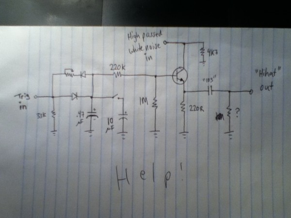

Hi there,
I'm looking for some help diagnosing a problem.
I've built up a hihat circuit, just by pasting together various bits of information I've gleaned from the web, then fiddling around on the breadboard.
I'm satisfied with the sound, which I'd like to maintain. Trouble is, whenever I route the signal through a buffer and/or mixer, much of the low frequency noise I filtered away somehow seems to become present again. I'm totally stumped on this one.
I've tested the buffers/mixers with other signal sources, and I can't hear anything funny happening frequency-wise, but with my hihat circuit, the difference is apparent. I've also tried swapping out different op-amps in my buffer, but all have the same effect. I am therefore thinking that the problem must be in my (dodgy?) circuit design. Attached is diagram for most of it. I've left out the noise source, but if someone thinks I should include that, lmk.
Any suggestions would be greatly appreciated.

Is it because the buffer is forcing a virtual ground?
Maybe try a 1K resistor between your circuit and the buffer?

When it does sound good, with what do you load the circuit, or what do you use to listen to it?

I have it plugged directly into some some dinkey, powered computer speakers.
I'm very curious to try adding the 1k.
Thanks for looking at this!

Ah ok, those are maybe not able to do the low frequencies or maybe have a bit of a low input impedance ...
You could try to put in a lower value for the output capacitor and / or lower the resistor marked '?'.

Hmmm, I'm a little confused. Changing the output cap is going to change the sound, and I've got that where I like it. Shouldn't there be some way I can buffer the output of this circuit without changing how it sounds?
Not that I've got the sweetest hihat here or anything... Just viewing this as a learning exercise.
Changing the "?" resistor shouldn't change the sound though, right?, I think it's at 1m right now.

Actually you do want to change the sound :p
You are getting too much bass when connecting it to a buffer, so make the cap smaller or the R smaller to get rid of that bass, then buffer it, and then it won't matter anymore with what you load it.
It may still not sound as you like on those speakers though, but then you can blame the speakers.

Omg, you're so right...
Gonna get to my studio later this aft to try these things out.

Well, I did a bunch of additional filtering before the buffer and managed to get the sound pretty close! I think I used a 1k at the output, then a .1uf, then a 2k2 to gnd at the buffer's input.
Thanks for the suggestions Smile
