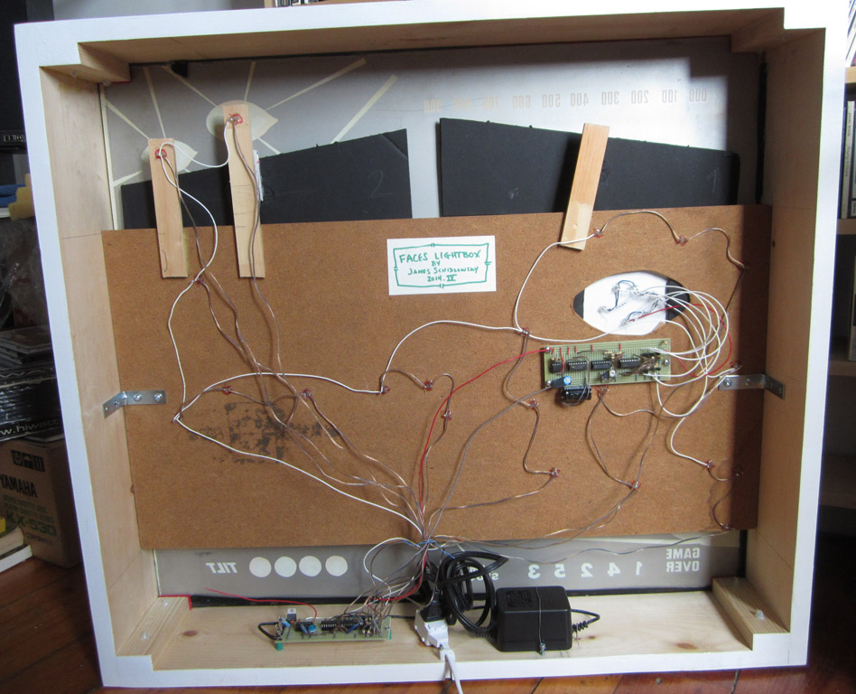

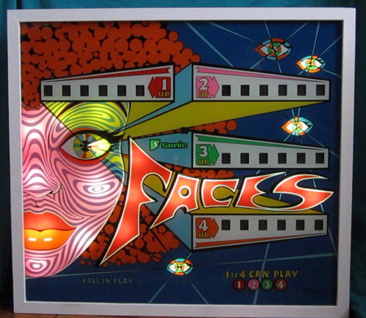

Pinball Backglass Lightbox Subject description: with electronical illumination animation |
I was hoping that PHOBoS would kick off this thread, since he created it (with Bubzy's blessings as well). Last month I had sent him a PM about a project I had finished that I thought he might appreciate. I didn't post it to the general forum because although it uses electronics, it is non-musical, and well, this site is about music.
And he replied that he had built something slightly similar, and non-musical, and had the idea of making a thread like this one for members of the forum who might like to share some of their DIY electronic but non-musical projects.
Apparently I had inspired PHOBoS to finish his non-musical project, the "TV PCB lamp", but PHOBoS being PHOBoS, ended up adding sound to it, which is why I guess he didn't post it here, but in his subforum here: http://electro-music.com/forum/topic-61742.html .
OK, enough of the intro. Let me get to my project...

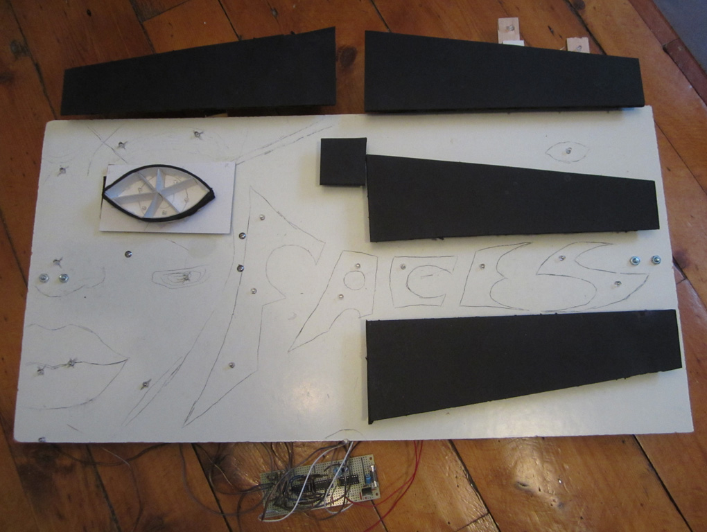

A friend of mine had this old pinball backglass lying around, and I had the idea of building a lightbox for it, with a circuit that would add a bit of animation to it.
Pinball machines from the 70s of course used incandescent lamps, but I managed to get away with 28 superbright white, 115-degree view angle flat top LEDs.
Apart from 18 LEDs just providing general illumination, there are 4 randomly blinking "little eyes", as well as a 6-LED speed-changing "big eye" chaser.
The speed of the big eye chaser was a cool little idea I worked out... the clock that drives a 4017 is a 4046 VCO, and then I have a 555 timer that switches it between 2 phases (via a 4053)... 1. charging a large capacitor (the VCO runs at the base speed), and 2. the VCO runs solely on the discharging cap's voltage, which starts out fast, and of course slows down as the voltage decreases. Each phase is around 35-40 seconds.
The little eyes blink driven by a 4-bit pseudo-random generator using a 4006 shift reg & 4070 XOR (a schematic I posted here: http://electro-music.com/forum/topic-52066.html). Unfortunately, sometimes when one plugs this box in, this circuit gets stuck in a zero state. I could never figure out how to get it to avoid doing that (without probably adding several chips). It's annoying because sometimes one can plug it, unplug it, re-plug it several times before it gets out of that state. When I make things for other people, I kinda want it to work without such hassles.
To add just a bit of extra randomness in the blinking speed, the clock that drives the pseudo-random generator is a 4046 with an antenna on the CV pin 9. So there's a base speed, but it can go slightly faster depending on what electromagnetic waves float by.
I acquired most of the knowledge for building this thing from hanging out on these e-m forums and building Lunetta stuff... thanks all!
DEMO VIDEO: https://vimeo.com/91720349
James.

It looks really great, glad you posted it
Is "TILT" visible from the front if you would put a light behind it ?

PHOBoS: Yes, TILT and any area that is not silver would light up if one puts a light behind it. In the "board" photo those black shapes are where I had to block light from coming through (like where there is plain glass through which one sees the score reels).
