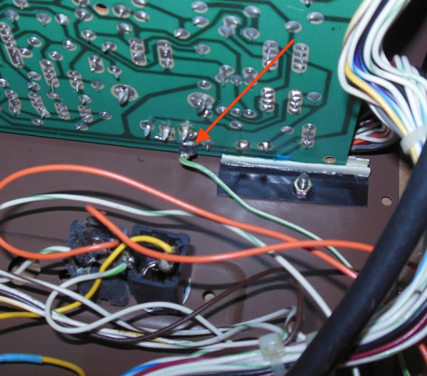

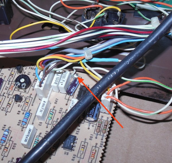

PostPosted: Sun Sep 28, 2014 5:13 pm    Post subject: Reply with quote  Mark this post and the followings unread
Not sure if the issue was resolved, 'cause the thread is a few months old, but in case anyone else has a similar issue:
There is a green/white wire that is run from the bottom board to the top board, from the + pin on C8 on the bottom board, to the ground pin of the Main Volume pot on the top board. If it is broken, fix it, if not there, add it!
See the pics below!
