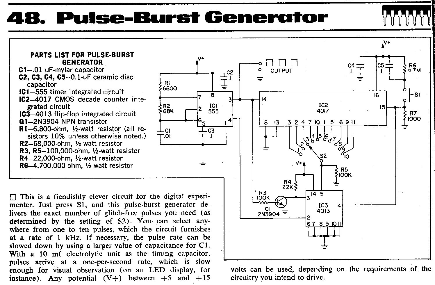

PostPosted: Fri Oct 17, 2014 7:03 am    Post subject: Reply with quote  Mark this post and the followings unread
ok, just recovery components and can assemble it in breadboard and see how it behaves.
Can I ask you a question? How about you have not tried ? Then with the clap how you solved? or have abandoned the idea of restoring the DR 110?
In the net I then found a circuit that does things similar to yours, but maybe simpler ...
What do you think?

roglok
Joined: Aug 28, 2010
Posts: 202
Location: uptown
PostPosted: Fri Oct 17, 2014 7:29 am    Post subject: Reply with quote  Mark this post and the followings unread
it's still on my list to do, but i want to finish some other projects first Very Happy
What do you think?
yes, the circuit is similar, but not complete. the DR-110 clap has two separate trigger lines. the three bursts are for the clap "impacts" and the single one is for the clap "reverb". i wouldn't call the circuit simpler either - it also uses 3 ICs and since it was designed for push button action, it is missing the external trigger input conditioning (LM358 used as comparator). Ken puts the 40106 to good use as both pulse conditioner and clock generator, thus eliminating the need for a dedicated timer IC.
exagonal
Joined: Sep 06, 2013
Posts: 21
Location: ITALY
PostPosted: Fri Oct 17, 2014 7:44 am    Post subject: Reply with quote  Mark this post and the followings unread
You're absolutely right, I kept in mind only now about the second trigger, I already knew!
In the end, it seems to me a good solution, but jet however the challenge for those who would like to program a small routine on a PIC, among other things I would like some advice on which model of PIC could use ..
