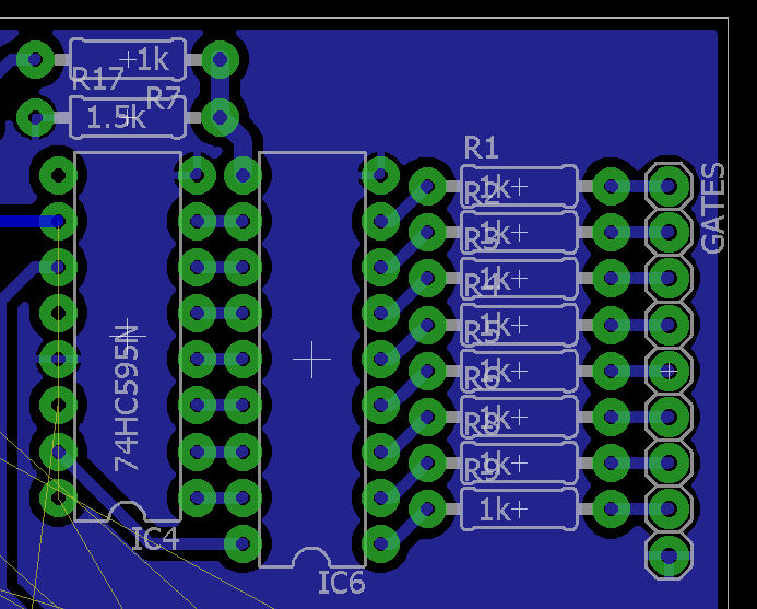

I've started designing my own MIDI-to-CV-interface for the modular I'm building.
I decided to roll my own, partly because I already had parts around that weren't incorporated in existing designs and I wanted to be able to expand the functionality easily.
On top of that, it was a chance to get acquainted with Arduino development, of which I had no prior experience.
I have very little experience with electronics design; I do have a basic understanding of circuits, common components, what they do and how they operate. I've been wading through tons of documentation, datasheets, asking friends who work in the field as well as fellow DIYers and makers, and I think I'm on the right track so far.
My design, which I've named the MegaVolt Wink, is based around the ATmega328 uC, an MCP4822 dual 12-bit DAC and a TL072 dual op-amp.
The DAC feeds CV into the op-amp which in turn buffers and amplifies it to a 0-8V range for 1V/oct tracking over several octaves. So far I've been able to calibrate it quite perfectly in software but I haven't actually hooked the thing up to any gear yet, so I'm uncertain how it will behave once I get there.
My hope is to avoid any need for analog trimming and rely entirely on software calibration; one thought I had was that one could hook the DAC up to an input on the uC and do an actual tuning pass, like you tune an analogue oscillator. It might be overkill, but if it turns out the conversion is too non-linear for some reason it's an option I might explore.
The two gate outputs are taken from the 328's digital ports through a pair of transistors in order to minimize current draw on the uC. There should be a software setting for different gate behaviour.
I've been considering what other outputs and features to include, right now it's pretty barebones with two CV outs and two gates, but there's also the possibility of a velocity output, in which case I might need a second TL072 or TL071 to handle buffering/amplification.
I've written a small C++ library to interface with the 48x2 DACs; it's bitdepth-agnostic and should work as well with 8-, 10- and 12-bit DACs. It uses an internal resolution of 16 bits and a simple dithering algorithm to increase the perceived resolution of the output. I have no idea how well it will work in practice, but I wanted a way to represent pitchbend more accurately since it's a 14-bit MIDI block. I'm uncertain if the resolution will be enough, otherwise there exists the possibility of using two DACs in parallel, one handling the more significant byte and the other the least significant.
Anyway, still a lot of speculation and throwing around ideas. My next step is to incorporate the second channel of the TL072 - I've only been using one for testing so far - and to hook up some MIDI equipment through an optocoupler and start handling input. Where I go from there depends on what I need and/or feel like doing. Wink
I'd love some feedback from more experienced people, especially about my circuit design. I'm extremely uncertain about most of it, but I'm at least confident enough that I dare to post it here.
What I'm most concerned with - and most unsure about - is stuff like short-circuit protection, over-current protection resistors or diodes, etc. I want this thing to be safe to plug things into, I especially don't want to burn out my entire modular system because I forgot some stupid detail.
you got the 1k Resistors at the output i think this is the max you can do...
is this working with the 6N135? my tests with a 6N135 didnt work... and i switch to a 6N139.
i thinking about few things when i look at your schem:
maybe you can use just cmos inverters or buffers instead the transistors at the output (so you can use one of the left gates to make a midi thru - or two).
it could be very usefull to add isp headers. (but you sharing some pins with the dac. maybe you need a jumper here)
i woud use each free output Pin of the ATmega to make an gate from it. (listen to a note of a other midichannel) for drum triggering.
Verry nice and professional looking project. i realy like it.

I might just go with putting the gates on the regular digital outputs of the ATmega. I'll run out of ports faster, but it will be slightly more efficient in terms of CPU usage.
And speaking of the gates, I'm not sure I understand why you thought it would be a bad idea to use transistors for buffering and amplification? I'm still not sure I understand the distinction in a buffer amplifier application. If the point is to simply amplify the incoming voltage and decouple power draw from the uC, isn't a tranny what I should be using?
So, are the 3904s on the gate outputs a bad idea? I could easily go with a TL072 or '074 instead for a dual or quad gate setup. It might even save some PCB space, come to think of it.

ups ... sorry i totaly missed your reply here. there is nothing wrong with transistors at the output. my sugestion was when u need a buffer ic for making a midi out you can also use that for the gate outs. (i always have the part cound in mind and the transistor and me is not the best story Wink ). I use nothing else but a 1k resistor on my ATmega328 on the outputs and i never killed a ATmega so far...

So last week I started looking more closely at the possibility of upgrading the Megavolt design to have more gates and CVs.
For gates, I looked around and read some forums etc, and settled on a design where I use a shift register - just one more pin on the ATmega328 - coupled with a ULN2803 tranny array. The array is fed by the +15V rail through a voltage divider, getting me ~9.6 or so V on the gate outs. It should be a fairly easy task to get it nicely laid out on the PCB, and it's just two IC's, a few resistors and filter caps, instead of the big mess the discrete trannies made with associated components - having eight of those on one board would've been impossible.
Then I was looking for a good quad DAC to replace two MCP4822's and stumbled on the LTC1458. It's only available as SSOP, which means opening a can of worms for me, since I'm etching my own boards. But I can't find any quad-channel 12-bit (or more) DACs in a through-hole package. An adapter board could work, but that still means soldering the DAC onto the adapter board. I would like to avoid that.
My main issue is that I want to keep the project approachable for almost anyone who wants to build it themselves. I don't want to go multi-layer PCB and I especially don't want SMD and vias to deal with. You should be able to etch your own board, solder in the components, program the ATmega and go.
So right now I'm coming up on the limit of what I can do in terms of using through-hole components and a small (7.5cm x 10cm) board. The ATmega, optocoupler, two shift registers (LCD + gates), a TL074 and two MCP4822's plus associated resistors, caps and I/O headers means routing the whole thing on a single layer is getting extremely difficult.
If I do move up to SMDs I probably would want to redesign the entire board, but I would rather have a working version using regular through-hole first, getting everything working, proper firmware etc, then move on to the next iteration.
So yeah, any input or thoughts are more than welcome. Smile

drakfluga wrote:
Thanks for the comments! gdavis; good luck with your project, sounds like fun! Smile
Is your design pin limited? I just used 8 digital outs for mine, didn't see the point in messing with a shift register.

gdavis; Again, thanks a lot for the input! Very much appreciated! Smile
It is, well, sort of. I do want to minimize the pin count on the ATmega - it actually makes routing easier too because I don't have to route 8 separate traces from the ATmega, it's enough with the SPI traces and then I can just put the s.reg and array next to each other - very clean!
Care to share your circuit for this? I watched one of your videos and you seemed to be struggling a little bit with this.

The circuit for the s.reg/tranny array thing is fairly simple, I'll attach a screenshot of my current layout below. You can see the shift reg with output lines to the tranny array, then through the resistors to gate outs. The entire board isn't routed completely, obviously, but that part is.
This isn't going to work like you think. The tranny array common pin is not a pull up, it's connected to spike protection diodes for use with inductive loads like a motor. The outputs are open collector and need their own pull ups. All the output can do is drive low, there's nothing to make it go high except the leakage current through the diode which is very small.
So, if I'm understanding you correctly, you're saying that I'll need a pullup to ~10V on each output, and this is because the current through the output is too low? Since it's just a low-current signal path? If I was using it to drive loads like servos, motors etc it would work like I've done it?
So I'd need 8 more resistors on there, which makes a whole lot of resistors.
I've googled some schematics where the ULN2803 is used but having trouble finding circuits where it's used as a logic/signal amp as opposed to load-driving. I can't find any example that looks substantially different from mine.
Can I change my design, is there another part I can use, or am I going about this completely wrong? I feel like such a noob! It seems every time I think I've got the hang of it, something bites me in the backside. Very Happy

drakfluga wrote:
You'll have plenty of current driving it low, but almost none driving it high. Think of the output like an SPST switch to ground. When the switch is closed, it's connected to ground so you get a good strong low. When the switch is opened, it's not really doing anything, it's just an open circuit.
Since this is an SS device and not a mechanical switch, you have some very small leakage currents that will make it behave weird when it's off.
That's not really a valid comparison because you're trying to drive a high impedance input. When you connect a motor, one side of the motor is connected to the output and the other side is connected to a power source. So when the output is enabled, it's connected to ground completing the circuit from power, through the motor, to ground. When the output is disabled, it just opens up like a switch, there's no longer a current path through the motor so it stops. The leakage current is way to small to affect something like a motor.
Now, motors can also act as generators and when they are stopped suddenly can send a voltage spike back through the transistor. That spike can easily damage the transistor, this is why the common connection is there. When connected to the power supply, it suppresses the spike through a diode. But this relies on a low impedance path to the power supply. The voltage divider you've put on there would cause two problems - the spikes wouldn't be suppressed because the current will create a voltage drop across it and when the output is off it will provide a path to ground through the diode from the motor preventing it from shutting off all the way.
yep.
It's not really meant to do what you're trying to do. Darlington pair is meant to switch a large current on and off using a very small current to control it. It basically compounds the current gain of a single transistor.
I wouldn't say you're going about it completely wrong, it's just not quite as simple as one might hope. I don't think you can do this with as few components as you're trying to do. You're not the first one to struggle with this.
Like I said, you can use the tranny array with the pull up resistors, but then it becomes a balancing act choosing the resistor value - small enough to drive the output high enough and fast enough, while large enough to not consume too much power when the output is low (which presumably it will be most of the time).
I wouldn't use a voltage divider to source the 10V directly to the output, I'd buffer it with an opamp (with much larger resistor values in the divider) or use a voltage regulator or DC converter.
Another option would be to use opamps to amplify the output. You would need two quad opamp IC's to get 8 outputs and two resistors for each output so still a considerable number of components, but straight forward, low power and if you use TL074's, they have built in short protection on the outputs so it would save you that resistor. This is what I'm planning on doing at the moment.
OH, I just realized you also don't have a current limiting resistor between the shift register outputs and the tranny array inputs, this is another big problem.

Couple more thoughts:
Look into resistor arrays and networks. Resistor arrays are basically several resistors in a DIP. Networks have one end of all the resistors tied together, reducing pin count - perfect for pull ups.
As I was falling asleep, it came to me that something like a DG333 might work for driving gate outputs. It's basically 4 SPDT MOSFET switches. The switches can be controlled by 5V logic, but can switch larger voltages so you could connect the throws of each switch to +10V and GND. The control inputs are high impedance so you don't need current limiting resistors, and you don't need pull up resistors, it's basically working like a CMOS driver.

gdavis;
Read your last two posts a few times, and gave it a lot of thought.
I think this is precisely what I'm going to do. Dual TL074's, with the shift register feeding the inputs. I can basically use the same setup as my CV outputs but feed them from the sreg instead of a DAC.
That was actually my plan initially - to just swipe the CV circuit right off and use it for gate, but I thought I could simplify it since it only needed to be constant voltage. Tried the discrete tranny solution, but it turned out messy with more than a few gate outs, so I figured a tranny array might work, but that just managed to dig me deeper into this mess. Sigh. Well, it's been a great learning experience at least! Very Happy
I completely forgot resistors on the sreg-outs. Wow, thanks, yes that's a pretty significant oversight. Wink
I've actually started playing around with an SMD-based version of the interface, designed for proper a proper fab run. I've switched from EAGLE to KiCad and it's growing on me. Both have their issues, but getting away from the limitations of EAGLE's freeware version is a big deal.
Smaller components, thinner traces, the option to use vias, and a double-layered board makes all the difference!
Will post some screens once I've wired the gate circuit up in KiCad.
PS. So, just to check my own (lack of) knowledge, the reason I can go with larger resistor values on the buffering opamp is because high input impedance, so very little drop in voltage across the divider? I'm always finding it difficult to know what to go for, I've tended to pick values in the 10k's, but maybe 100k's or even M's would be more appropriate here. Power conservation is important!
So maybe I should go higher on the CV outputs as well, right now I'm using 39k/27k to set the opamp gain, but maybe I should go 10x that or more?
Cheers!

drakfluga wrote:
gdavis;
Seems like it should be simpler, doesn't it?
I did some more searching and came across the CD4504B hex voltage level shifter. Seems like a winner to me if you can give up 2 gates or add another IC Wink
I think KiCad is my favorite free layout program, though I haven't used it much for various reasons.
Exactly.
General rule of thumb is that the current through the divider should be at least 10X the current being drawn out of the divider. In most cases, this makes the effect of the load small enough to be considered negligible.
The trade off that needs to be taken into consideration is noise. The higher you go, the more susceptible it will be to noise. This will be much more noticeable on CV's compared to gates. Anything in the 10k to 200k (very rough) ballpark should be fine.
