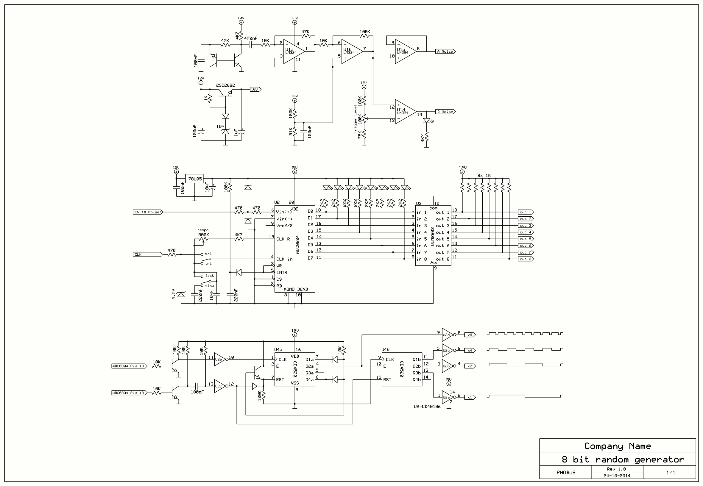

I was wondering about how to achieve several random bits from a noise source. My initial thought was to create
a couple of bandpass filters followed by comparators, but then I wondered what would happen if you add the noise
to an ADC. So I did a quick test and that seemed to work quite nice as a random bit generator Very Happy.
So here's the full circuit consisting of 3 parts: a noise source, the ADC and a sync generator.
The noise source is pretty standard however I noticed that it was quite sensitive to noise on the powerline which
the ADC was producing so I used a transistor and a zenerdiode to create a 10V voltage stabilizer. The 2SC2682 is
something I had laying around but you could use something else, it doesn't have to produce a lot of current
so a standard NPN should do.
U1a and U1b amplify the noise signal and U1c acts as a buffer. U1d is a comparator to create a random CLK source.
The ADC has a schmitt trigger inverter between pins 4 and 19 which can be used to create an internal oscillator.
There is a switch for 2 speeds (LFO, audio) and a switch to select an external oscillator (might be fun with a VCO).
The ADC works on 5V which means the output levels won't be high enough for other circuits that I power with 12V.
So I used an ULN2803 (darlington array) as level shifters. Downside is that it inverts (which is why the LEDs are
connected between the outputs of the ADC and +5V) but for a random generator it doesn't matter.
Because the ADC takes 72 CLK cycles for every conversion you can't just use the CLK to sync it to something else.
So it first get's divided by 9 (U4a) and then divided again (U4b) which creates 4 outputs that are in sync with the outputs.
Well the tempo is the same, it only gets in sync after bit 0 of the ADC turns from low to high.

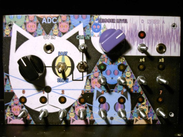

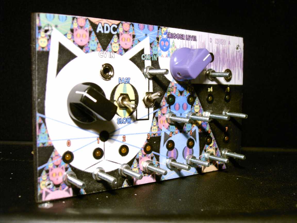

Finished this one Cool
(only needed the knobs and a 1/8" socket)

cbfishes wrote:
This looks awesome! I don't think I understand the ADC/8bit part, but I think I mostly get the noise creation and random clock. That's cool!
Any audio? Would love to hear what this sounds like
The ADC converts the noise generator (which is just a random voltage) into 8 bits. 0V results in 00000000,
5V in 11111111 (actually it's inverted) and of course you get every binary value in between. Because the
voltage is random the bits are random too. I could also connect an external voltage to it instead of the noise generator.
It's not a Flash ADC so it doesn't happen instantly but all the bits change when the CLK goes high,
so I can change the speeds of when the bits change. So it's like a S&H except that the output isn't
a voltage but an 8 bit binary value.
It doesn't really produce any audio, well I could turn the speed up which would result in 8 bits of digital noise.
But it's just a way to create 8 random bits which can be used to control something else.
