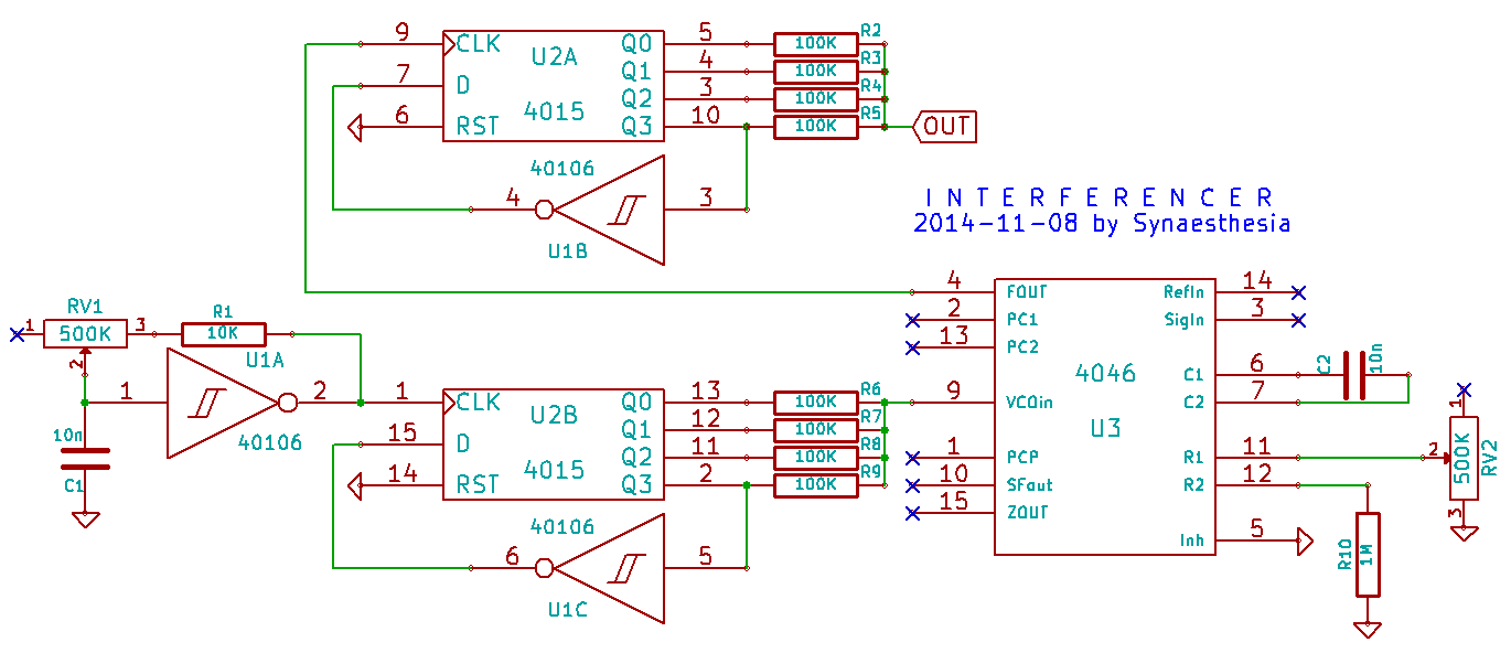

The 4046 PLL is a chip that I haven't used before. So I finally sat down and played with it a bit. So far I am using only the VCO part, which works just great.
The first snippet is meant to emphasize the interference sound that you get from mixing two close frequencies. However, in the INTERFERENCER circuit, I am feeding the VCO not with one voltage, but with a fast triangle wave from a first shift register. The resulting frequency from the 4046 is then divided down by a second shift register. When tuning the triangle wave frequency against the VCO range, you get many places where a nice interference can be heard. Listen for yourself. In the first half of the recording I am only changing the triangle wave frequency. In the second half I am only changing the 4046 VCO range.
