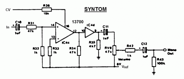

I would recommend an OTA. You can get two VCA's with one LM13700. I have done it by replicating the configuration used in the JH Wasp filter schematic.
You will need to make sure you attenuate the voltage on the input. OTA's distort easily and the distortion does not sound nice. Also, add a 15k resistor to +V from the diode bias input. |

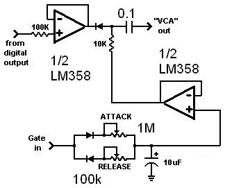

It started out that way, but without the 2nd diode of the 2-diode design, it more resembles the "1-transistor VCA" used in the TR-808, TR-606 and DR-110: The output is taken from the point where the CV controls the amplitude.
Using an opamp instead of a transistor as the active element allows for a larger input amplitude. In the 1-transistor circuit the input must be limited to less than the transistor's base-emitter saturation voltage -- about 850mV for a 2N3904.
(In that circuit Gate In needs a resistor of 2K or so to Gnd, otherwise Release will be longer than it should be.) _________________ Revenge is a dish best served with a fork... to the eye |

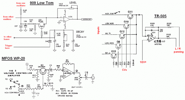

I failed to mention that omitting the 2nd diode from the 2-diode VCA the circuit handles analog as well digital inputs. Replacing the transistor in the "1-transistor" VCA with a single supply opamp makes it even better, as it allows bigger input swings.
| Quote: | | I've got my eye on this guitar compressor schematic at the moment. I think using the OTA as a voltage controlled resistor in an op-amp feedback loop would hopefully work well. |
I agree with LFLab that looks like too many parts for a single-supply VCA, unless you have your heart set on the compression capability.
Here's a couple more core circuits:

| what's missing is the V/I converter. |

| Same operation as what PHOBoS posted. The 909 circuit is dual supply, but that's just for the opamp. Substitute a '324 or '358 for single-supply. |
