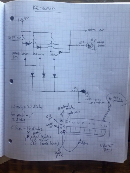

@cbfishes: Can you post some info and or schematics on the keyboard? I'm interested in trying something similar.
I don't have any schematics (except the one I think I drew in my notebook)– I had an idea for a keyboard like this and found this:
http://www.cgs.synth.net/tube/controller.html
That circuit has some cool features like sample and hold, but I wanted to stay super-duper simple. I'll see if I can snap a pic of my schematic and post it here– it's basically that CSG schematic with no op amps. I don't remember how I did the "gate" output– I think I tapped the first pin on each of the potentiometers so when the "key" circuit completed, the full 9V flowed through that first pin.
I'll tell you what– it really works great for such a simple circuit! The only problem I have is using soda can metal for the keys. Boy it's hard to solder to that! What I really need to do is get some scrap metal and swap it out. But for now, this is a great way to play melodies without having to deal with exponential response.

Yeah, I'd like to see how you did gate. I ran into that circuit before but forgot about it. Aspects of it I understand. I don't exactly get the trigger part and I'd want to cut that out anyway. I wonder if I could eliminate the JFET & the op amp buffer in front of the trigger and still have it work... I might try to experiment with this and see.

Here's a quick pic of my messy circuit–
Basically, an alligator clip connects directly to 9V. When the clip touches one of the "keys," it sends voltage to two places: a 1M pot and a "gate bus." I stuck diodes between the key and and "gate bus" because it didn't work without it (not sure why).
The voltage coming out of the 1M pot is variable (because it's a pot!) and that goes through a diode, which then gets summed together to the "CV output." If I clip the 9V to my wedding ring I can touch the keys (much less voltage goes through) to play notes or whatever. I think I put 1k resistors on the outputs.
Hope that makes sense!
