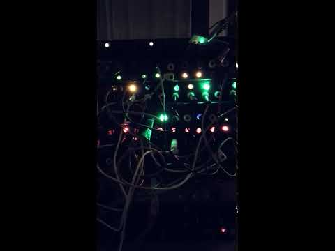

hi synth diyers,
I'm all for diysynth. now I'm making sounding and lighting vhsboxes for 4 months. learning electronic by trial / error. before I was roaming this forum like a psycho. all by myself with your very very helpfull topics. I'm more attracted by lunettas galaxies but modular spaceships synth diy were my first target.
one of my last video
http://m.youtube.com/watch?v=sME9MYgppAA
coming soon with questions

welcome Sethkaine!
Very cool sound and light show! Could you post a picture of your build at light please? Using VHS boxes sounds like a cool idea and I would like to see your build in more detail.

PostPosted: Mon Sep 28, 2015 1:45 am    Post subject: my modules Reply with quote  Mark this post and the followings unread
Hello synaesthesia,
Nice name by the way. Razz very colorfull.
I will put pics soon of my VHS boxes modules. They're not definitive I have few modules to build before I evolve my system to bigger boxes.
