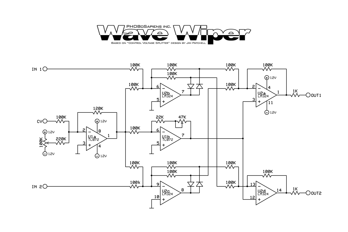

You could use the other half of the '72 as an attenuverter on the CV input either as replacement or complement to the 100k attenuator.
R |
Joined: Jan 14, 2010 Posts: 5884 Location: Moon Base
Posted: Thu Dec 31, 2015 3:28 pm Post subject:
good idea. And I will be able to fit that on the board, which I am going to make a little bit larger anyway.
I do have a bit of mixed feeling about attenuverters though. It's great to attenuate and invert a signal with one knob,
but it's not as easy to set to 0 as a simple attenuater. I've only tried a very simple version though, don't know
if the one with the trimpot makes any difference. So let me try that one too  _________________ "My perf, it's full of holes!"

best wishes for 2016!
I just tried the one with the trimpot and as I was somewhat suspecting it is to zero the center of the pot.
That would work great with one of those pots with a center click.

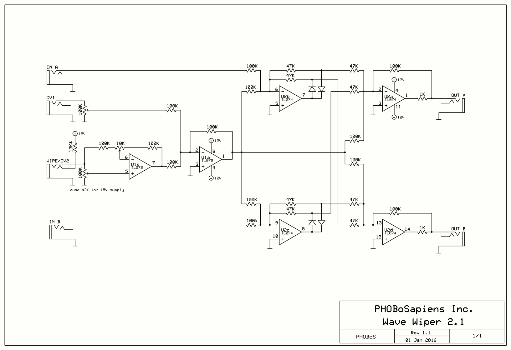

I am thinking of indeed making 2 CV inputs, one with an attenuator and the other one with an attenuverter.
If I then add a positive voltage using the switch contact of the jack I could replace the wipe pot with it.
At the moment I designed it so that the wipe pot can add so much offset voltage that in the most outward
positions it will "override" the CV in. The nice thing with the attenuverter is that by changing the resistor that supplies
the positive voltage (when no CV connected) I can still set a larger range than when using a CV.
So the circuit would function exactly the same as it does now but with the added bonus of having an extra CV input
and for that one the wipe pot acts as an attenuverter. Also if I add the trimpot I can zero the center of the wipe pot.
It doesn't have that option now but I guess that would be nice. _________________ "My perf, it's full of holes!"

Dave breadboarded the WaveWiper v2.1 to do some tests but he had some problems with the attenuverter part.
I breadboarded it too and got the same results he did while I knew it should work. As it turns out I made an error
in the schematic, so I just uploaded the corrected version. Luckily the Eagle schematic I used to design the PCB is correct.
| piedwagtail wrote: | I can see from your neat parts placements how this is an extension of your enjoyment of drawing schematics.
Did you use auto-routing? I never do puzzles, but I really enjoy the 'puzzle' of routing a pcb. |
auto-routing ?!
And yes I do enjoy those puzzles a lot too . And I am used to it, I always design a PCB when building to perf.
But good thing it isn' t my job else would have probably been fired for spending so much time on 1 small PCB. _________________ "My perf, it's full of holes!"

I've always used the Ian Fritz version with 220k signal to - terminal and 220k feedback resistor.100k pot. With 15/0/-15 I found it worked as advertised with CV signals until -13V then it wasn't happy; which is pretty extreme.
