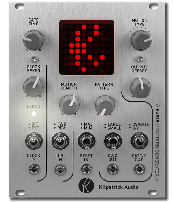

g.gabba wrote:
props
Damn the idea to use a diodematrix to show the pattern is so damn good - it could be mine,
toping up: two in a row to have 16x8 and bicolor to show the actual step ^/v lane.
Well.. to be honest... I was inspired after seeing a Youtube video of the Killpatrick K4815.
I had a LED-matrix in a drawer on my desk, and I just had to do something like it.
The programming of this module is the hardest I have ever done with an Arduino (clone).
