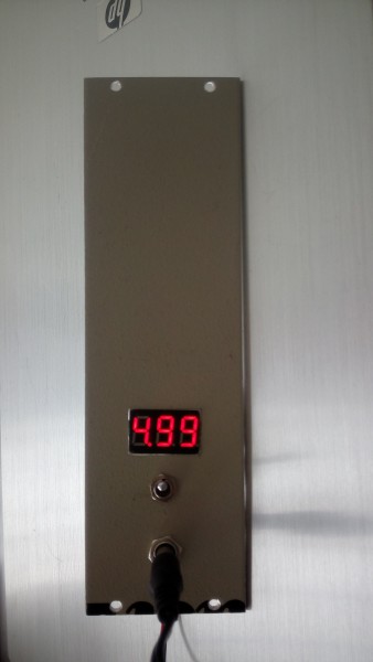

Posts: 1318
PostPosted: Sat Jan 19, 2019 4:15 pm    Post subject: Reply with quote  Mark this post and the followings unread
piedwagtail wrote:
Here's the icing for the cake
https://www.aliexpress.com/item/Mini-Digital-Voltmeter-Voltage-Tester-Meter-0-28-Inch-2-5V-30V-LED-Screen-Electronic-Parts/32854836483.html
Cool
 Filesize:  1.21 MB
 Viewed:  290 Time(s)
my synth

I think I'd find an ammeter more useful. after all the voltage is constant unless there is something major wrong.
https://www.aliexpress.com/item/Mini-Digital-Voltmeter-Ammeter-DC-100V-10A-Voltmeter-Current-Meter-Tester-Blue-Red-Dual-LED-Display/32947073204.html
Posts: 5862
PostPosted: Sat Jan 19, 2019 6:26 pm    Post subject: Reply with quote  Mark this post and the followings unread
Being able to see the current draw or in this case even better both voltage and current is great. But I wonder if it could affect the
voltage since you need to place it in series* with the power supply. Just voltage is useful too though, if it starts to drop you know
the current requirements are higher than what the supply can handle. It might not drop a lot but it is definitely measurable.
* unless it uses induction to measure the current.

I use those voltmeters on each rail; on lights with an additional safety feature.
If there's a fault, accuracy is not the issue, immediacy is.

I saw a spec for the ammeters resistance somewhere once IIRC it was less than 100milliohms.
I was more thinking about possible high frequency noise as they are digital or maybe problems if something goes wrong with them.
Not really something to worry about it though. I actually looked at those meters when I was making my own supply but they were
too large to fit on the panel so I settled for some small digital volt meters.
I agree that accuracy isn't that important it just has to indicate if there is a drop in the supply voltage.
