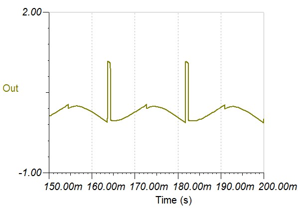

The Variophon synthesizer is very rare. It used a method of synthesis called "pulse forming synthesis", and this method is in fact almost impossible to replicate by stringing together standard synth modules, even though it is quite simple in concept. So I designed and simulated a circuit for it (TINA-TI) and generated some out audio, as a step to stimulating interest.
The basic idea is merely that the output has a fixed width pulse for every frequency: i.e. not say 50% of the wavelength but say 1ms regardless of frequency. (My implementation is just a comparator driving a monostable multivibrator with a selectable on period. Not complicated.)
What does that do? It allows a particular kind of formant generation, one that approximates pretty much of what happens in blown instruments like reed or brass instruments. There are academic papers on it, but let me explain like this: turn your ideas upside down.
First imagine a standard VCO with a pulse output set at 25% running at 400 Hz. Now imagine that we build a circuit to generate exactly the same wave, but using a sawtooth VCO going through some complex fixed filter (or convolution). Now imagine that you change the frequency of that sawtooth VCO going through that same fixed filter: you get the same kind of equalization or formant pattern, but it affects different harmonics now.
And it turns out that this is what happens when you have a fixed pulse waveshape, and you vary the space leaving the mark constant. This is "pulse forming" synthesis.
My implementation has two wrinkles: first when the note goes high enough that the pulse gets to 50%, it won't go more than 50%. And second, it allows you to mix in extra fundamental by having a fixed LPF at around 100Hz. Otherwise low notes get mighty thin.
Here is the circuit. (It really assumes a saw or square input (downward ramping) for the pulse guard.)

Example waveshape at 55Hz and Width knob at half. |

And here are various sound samples, generated by the circuit simulator (not built): more in the next emails.
They are static so they don't really convey in isolation the effect. You would want to follow the same width at different pitches, but I have uploaded the files according to pitch, apologies.
They are at 27 Hz, 55 and 220. There are three variations, for different Width settings.
