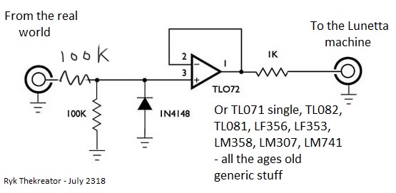

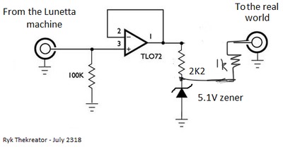

Recently shared with me from a long time lunetta mad scientist and forum member for protecting lunetta from eurorack etc and also protecting eurorack etc from lunetta! I’ve attached their diagrams for input and output protection, please comment if you have any recommendations or Improvements!

ok, my thoughts on it, let's see
For the first circuit there shoud be a resistor in series with the input. Without this the diode will just short negative voltages to ground
which can be bad for modules (depending on the kind of protection they have) and it will also affect the signal if you would use it with
a passive multiple.
For connecting to digital inputs I'd use a comparator instead of a voltage follower. I actually did make a circuit for that recently:
(note: the AND gate is made by just having a switch in series).
For the second circuit the output should be taken from the connection between the zenerdiode and the 2K2 resistor, otherwise the zener
doesn't have much effect besides wasting current. _________________ "My perf, it's full of holes!"

Like so, Phobos?

PHOBoS! Omg, omg. I thought I knew the littlest bits of theory over the years of DIY electronics but ...
The above error corrections of yours, were as to my schematics that Colorbars had shared.
I remembered that the 2k2-2k7 as per the zener, is for current limiting as to the load that it drops. I had forgotten though, having to take the output from between the resistor and the zener. Thank you for THAT reminder!
The other one ... with the diode to Ground to protect from -V "coming in" I hadn't even considered the amount of current that COULD be transferred that way.
I believe now, that I had mistakenly assumed, the 100k to Ground impedence for the chip, from the LOGIC world, had applied equally, to the opamp world! Hence ... my often putting them to Ground, instead of in Serial.

colorbars wrote: | Like so, Phobos? |
almost, but place the resistor on the input between the 100K resistor to GND and the diode, otherwise it will
form a voltage divider. Oh and I'd use 1K, although 100K will probably work fine too.

oh and another thing. You could place the zenerdiode on the input of the opamp instead of the output. (So the circuit would
be exactly the same as the other one but with a zenerdiode instead) This way you don't get any extra current limiting from
the 2K2 resistor so you can drive a bit more with it. Downside is that it will 'pull more current' from what you connect to the input. _________________ "My perf, it's full of holes!"
